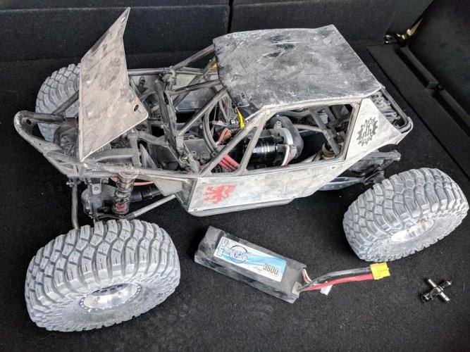

Man, I'm baked... it's 102 right now.
All the electronics were to the point to where I could only leave a finger on them for a couple seconds...
Used up 1 pack, got in the car and drove to another spot - got about halfway to 3/4 through it and servo locked up (WTF?).
It's extremely hot as well, got some food on the way home and going to test it out in an hour or two in my parking lot.
This is a ProModeler 470 with a finned all-aluminum housing, getting 8.0v from the Mamba X BEC - only other item getting power is the FlySky receiver.
NOT something I expected!!!
Will be back later with more info...
(BTW - it's centered, and I was not driving in an area that I would have got in a bad bind - light buzzing from the servo)

These bombers look way better to me with dirt and dust all over them. I like how the motor is still shiny, glad I could hear the famous sound from your videos. Sucks about your servo! Im sure it had a good run though :twisted:
Oh, man, that servo thing sounds very similar to what I went through... - really hope that it is not! :roll:
Moderate driving, really hot... all too familiar circumstances...
But the trucks is getting nicer with all that dust on it! "thumbsup"
Well, servo is non-responsive - even after removing linkage to make certain I didn't have a pebble jammed in the steering somewhere...

Sorry to hear about the servo issues, thats a bummer. You should contact the Owner of ProModeler he's super nice and I'm sure he'll try to help get it sorted out.
Did you have another rig to plug this servo into just to confirm its the servo and not something else?

EDIT: Tested in Ascender, servo just buzzes when power is turned on, doesn't respond to steering input... No Bueno. :evil:
Did you open up the 470 to look at the gears? It's super easy to put back together.
Sent from my Pixel using Tapatalk
I was thinking I'd give John a call over at ProModeler in the morning first, then I may check them...
The strange thing is that I was not doing any driving that ought to stress a servo out - there were no binds, ass-over-teakettle tumbles, high-speed crashes...
I was really taking it easy.
Might have gotten a defective one, I dunno...
