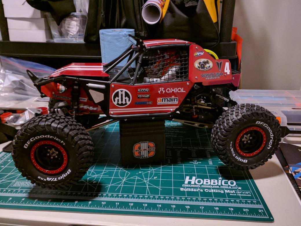

Working on some scale items tonight and i need input.
Does this look any good?
It's not fixed yet so i can move it around.
I was also kinda forced to use my half-ass painted heads since my airbrush guy is overwhelmed and won't paint my nicer heads until the summer.
I went ahead and installed the lego nets. They may not stay if they are more annoying than good looking...
Next up is a final tuning of the hobbywing 1080 and some dielectric grease in every connector then i can put the cage over the skid plate!

I want the high lift jack too, torn over the inexpensive plastic one or the expensive functional one for more scale points.
I was thinking of getting a battery to put where your fuel can is.
Nets look great lol now I feel like I'm copying off you since I just ordered them my self lol.

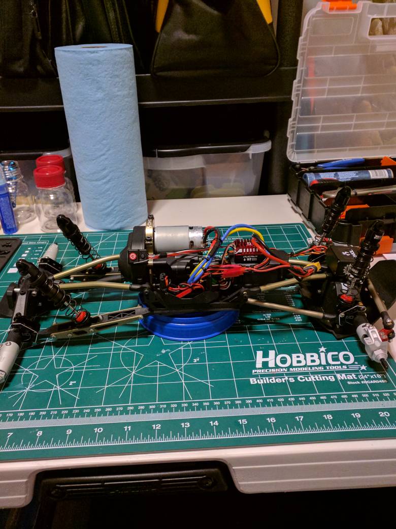

Really thought i had it tonight but after rebleeding the gmade XDs to use low pressure, adjusting the ESC, installing the shocks and yelling at Led_Blue on ebay (missing my red beadlock rings...) i couldn't get it all buttoned up.
I also had the wiring for the lightbar messed up and it became too hot to touch [emoji33]
I was able to save it and now it's not even warm after being lit for 10mins.
It's sitting a few screws away from being drivable!
Sent from my Nexus 6 using Tapatalk
Okay i guess it's done [emoji33]
Tomorrow i'll put the kit wheels on and take it for a spin.
My only concern is the shocks, the springs are soft, even the hard ones feel soft in the rear.
The truck compresses the shocks about 1/4 or 1/3 when i put it down...

It's alive!
I ran it inside the house for like 5 mins since the battery is in storage voltage.
The hobbywing 1080 is completly silent at 16K, almost weird since you can hear all the mecanical parts working...
The Titan 550 21T motor on 3s is super smooth at low speed and still decent fast on the 11/64 gearing.
I need to set the EPA and decide on the amount of drag brake before running it outside.
Right now i think it will front flip if i run fast...
Do you know if the drag brake still applies in Fwr / Brk / Rev mode?

I'm not familiar with the HW ESC, but every other ESC I know of with drag brake, it applies all the the time, in forward and reverse, any time neutral position is detected.
As for your shocks, mine also compress about 1/4, but many people like a lower ride, because it gives better handling at nay sort of speed, these things LOOOOOOOOOVE to roll over, even with the rear sway bar.
My trailing arms are almost level the way mine sits.
I used lots of "goop" glue for the shoelaces.
Put some CA glue or tire glue on the laces before cutting them, it will prevent strands from separating.
I really like the Gmade XDs, smooth and easy to build but they are 1mm shorter than the kings plus the bump stop is HUGE so you lose at least 3-4mm of travel.
I might have to look at Pro-line or Traxxas Big Bores eventually...
Hopefully the gain in stability from the lower ride height along with the larger track width from the 475 hubs will out weight the loss of shock travel.
