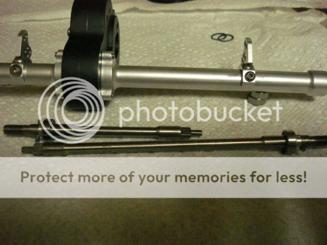

Axle parts pics
Re: Tedrockzs 2013 berg build

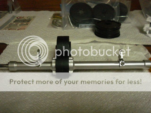

This somewhat of a live build.....

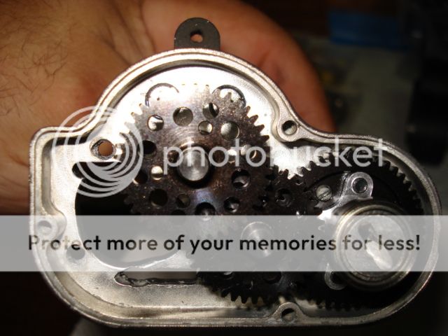

RC4WD locker replaced the RcBro unit. Lighter and just plain looks better:ror:
Pay no attention to the hogged out motor mount area. Bought it second hand that way. Still works fine just looks like shit, most likely will be replaced...
Front tubes mounted to the boxes

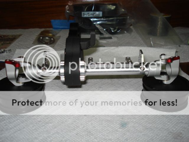

Front axle semi complete......Cccmmmmmmmmmooooooooon Super Dave:ror:
On to the ass end.....:ror:

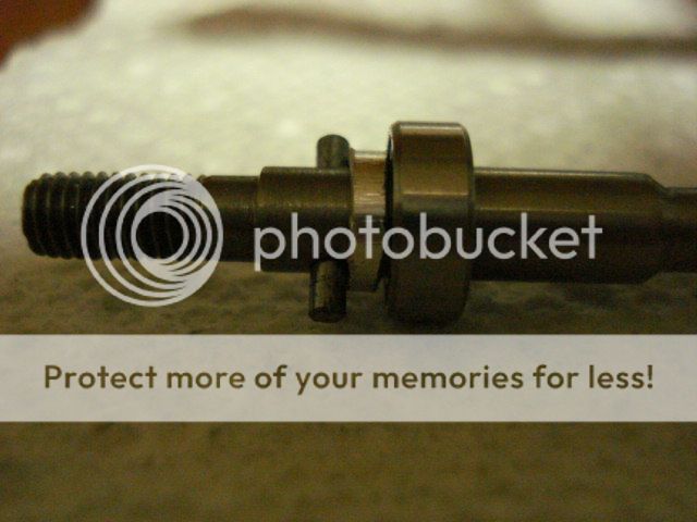

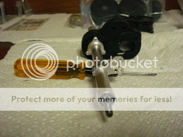

Not so pretty. Straight out the package. Got them last mid week.
Pretty
Gunnars pins compare to RC4WDs pins. One of the stock was already bent pretty bad. Gunnars pins or similar is a cheap bit of insurance IMO"thumbsup"

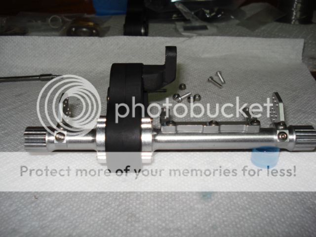

Rear
The creeperbobs
More Gunnar pins
Finished rear minus a rear link mount. Shit's hard to keep up with ordering parts. Will get one on the way here in a bit.
Bout it for the evening. More parts coming in tomorrow and Thursday"thumbsup"
