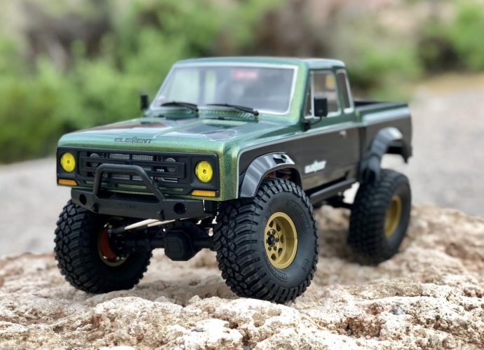

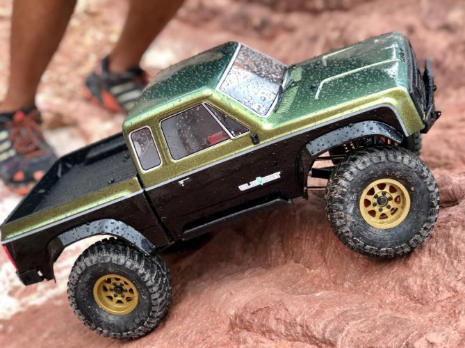

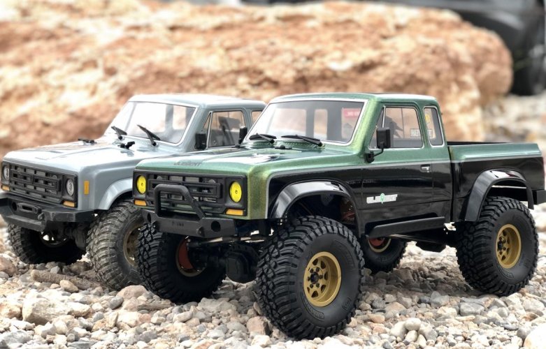

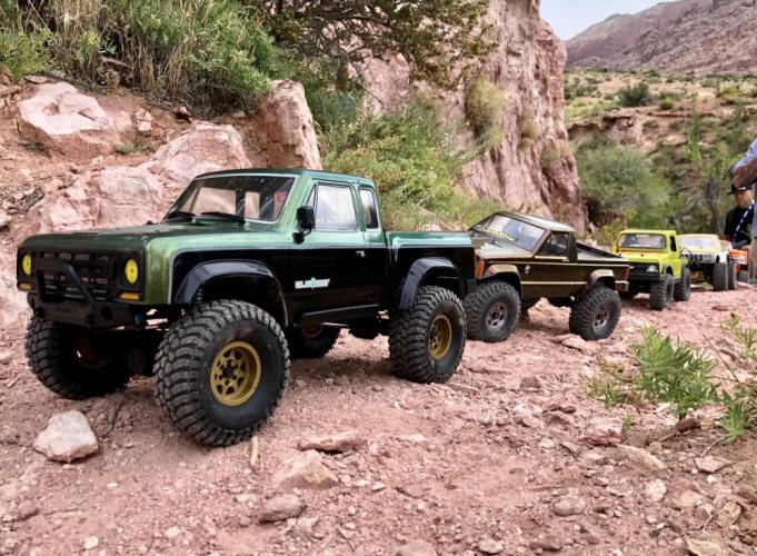

Some pics of Rodney’s enduro, from battleborn rc paint. Another friend and I really stretched the legs on his, got it to pull some nice lines and check its limits. Pretty impressive out of the box, hope to have a video together later.
Nice paint job! It took the appearance of that body to the next level!
I’ve been thinking about a 2-tone color for my future Enduro. Still not sure on the colors yet.
