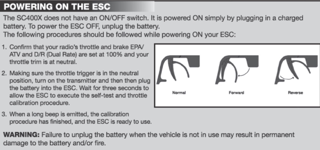

I just got mine, but I can't seem to find the power switch on the truck. The moment I pop the battery in it starts up. Do they come with one on the receiver or is this standard?
All in the first line in the manual.......
Hang up and Drive
Actually seems like Associated paid attention to everyone bitching about failed switches!
Yep, no switch. I got a HW1080 for the power switch and jack-rabbit reverse, but switching motor leads fixed the latter. So its still in the box.

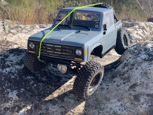

So I got to maiden my Enduro yesterday. It lasted all of 30 seconds before the axle housing broke. One of the screws that holds in the bearings broke out of it's threaded hole :flipoff:
Unfortunately the hard axle housings weren't available when I ordered my kit, but I've got them on the way now. What a disappointing first day. Good thing I took a couple more rigs with me. Anyway, here she is...
That's a bummer!

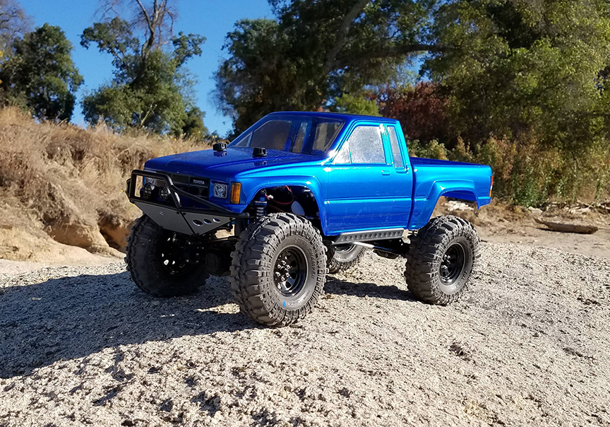

I trimmed the Lexan bedliner for the utility bed, sanded the edges smooth - need to put the body post holes and mounting screw holes in it tomorrow and test fit it.
I'll be painting it soon... and am still thinking about how to paint up the RTR cab body.
It's really thin, might not last that long - so I may be doing something beater-ish...
So far, keeping it very light - the only added weight is Element 6mm steel hexes, and SSD steel wheels.
Instead of a steel front bumper I got from RC4WD, I decided to stick with soze's idea of the GMade BOM plastic bumper - it really matches the utility bed well - tubes are looking the same diameter...
That's a bummer!
Which wheels and tires are these?
SSD 1.9 Steelie 5-slots, RC4WD 1.7" Interco Boggers (pre-siped)...
