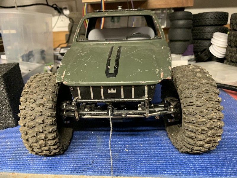

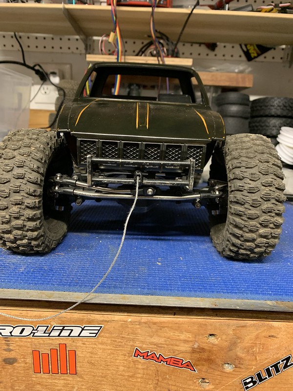

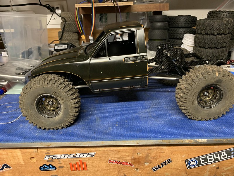

Updating a couple of my threads since it's been so long. This rig has seen some changes since its original form for sure.
This rig is now running
SSD diamond front axle w/ SSD brass knuckles and Samix aluminum C-hubs
SCX10 iii portal axles in rear
Creeper-t (flipped)
Yellow Jacket 2000k
SVH500.
3 link set up with InTheWorksRC links (mixed from a few different sets).
1A5240F6-F745-410D-8662-BA3252CD67C6 by T Buggy, on Flickr
61DF0BCF-AFB9-4E11-8CB3-F9CEE542093A by T Buggy, on Flickr
Wiring is still not completely tied down not sure if I am leaving it in this configuration for good or not. So far it seems to work out fine, probably not as balanced as I would like but haven't really had an issue with that yet either.
080B1F0F-0F8B-4C5A-A5A8-E3B55FDF7164 by T Buggy, on Flickr
I did stretch the wheel base a bit and its now 12.75".
6046AF37-4FA7-4060-A9FF-BAF07EC901FE by T Buggy, on Flickr

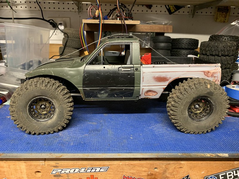

Also painted up another body, this time a cab only. I think it turned out pretty good. The main part I was proud of was being able to keep the hood lines while still pinching the front end. I wanted to keep that look so it looks like the hood is a separate piece still.
CC985664-AE7D-41B6-9D1E-B61185BF744B by T Buggy, on Flickr
9AA8DA6B-2ACB-4E14-83AF-4D715BD775D9 by T Buggy, on Flickr
3E02CF57-5C63-49ED-ABD1-125B9D4F6410 by T Buggy, on Flickr
