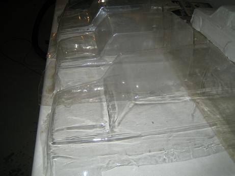

after some major procrastination, lots of time, money, and frustration we finally did it. the mold is very basic, but it captures the zuk feel. still have to work out issues with the material thickness and webbing. they're definitely not perfect. approx 8th scale.
starting from the super suzy magazine cutout, to the mold, to the first pull, to three pretty good pulls.

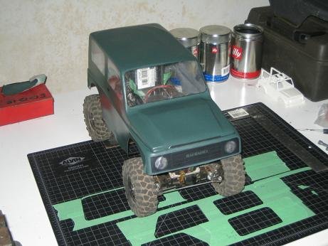

Here's one with some paint. Kind of ugly! Mocked up on my sw2 chassis shortened to 10.5" wheelbase.

It might be mostly just the scale, but your Sammi body looks MUCH better than the production one!
Add some flares, and make the windshield smaller, and you will have nailed it! "thumbsup" Nicely done
Thanks for the compliments guys! I'm reworking the mold to fix some issues that we saw with the first few pulls. We'll see if can add some flares in there. Will probably start up again later this week.

Great feedback! This mold was intended to be a hardtop, but maybe in the future we can change it up to be a softtop like the one shown above. Still working on the mold, but in the mean time I threw some paint on body #2 and hacked away at it to fit my 2.2. As you can see, we have webbing issues on the rear quarter panels. Also looking for a better option for grille stickers - more research... also have to do some work to remove the suzuki name.
