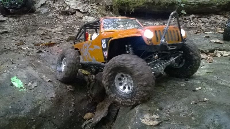

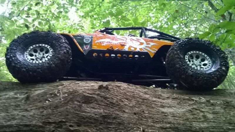

I also got to attend my first Recon G6 this past weekend down in Florida at the Killer Clowns of Krawlzone. Jeepers performed awesome and I also earned 1.9 Driver of the Day.
Some shots from the event.
