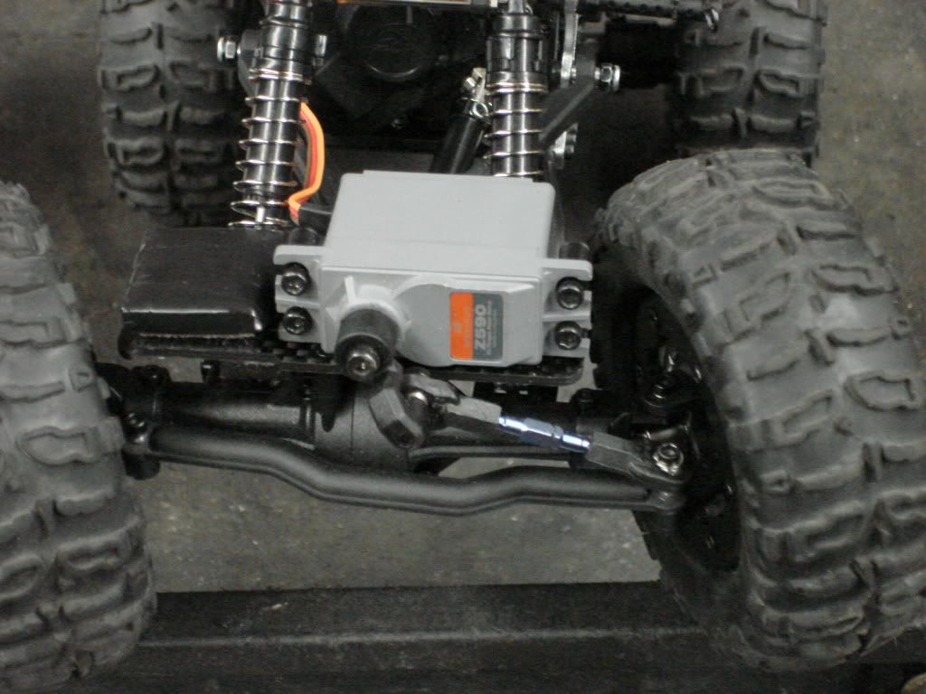

-2 oz. stick-on lead inside each wheel, 1 oz. under servo plate, 1 oz. next to servo
-Spektrum full-size metal gear servo, no servo saver
-Steering link made from Ti turnbuckle and Traxxas rod ends (I had to sleeve the rod end at the knuckle)

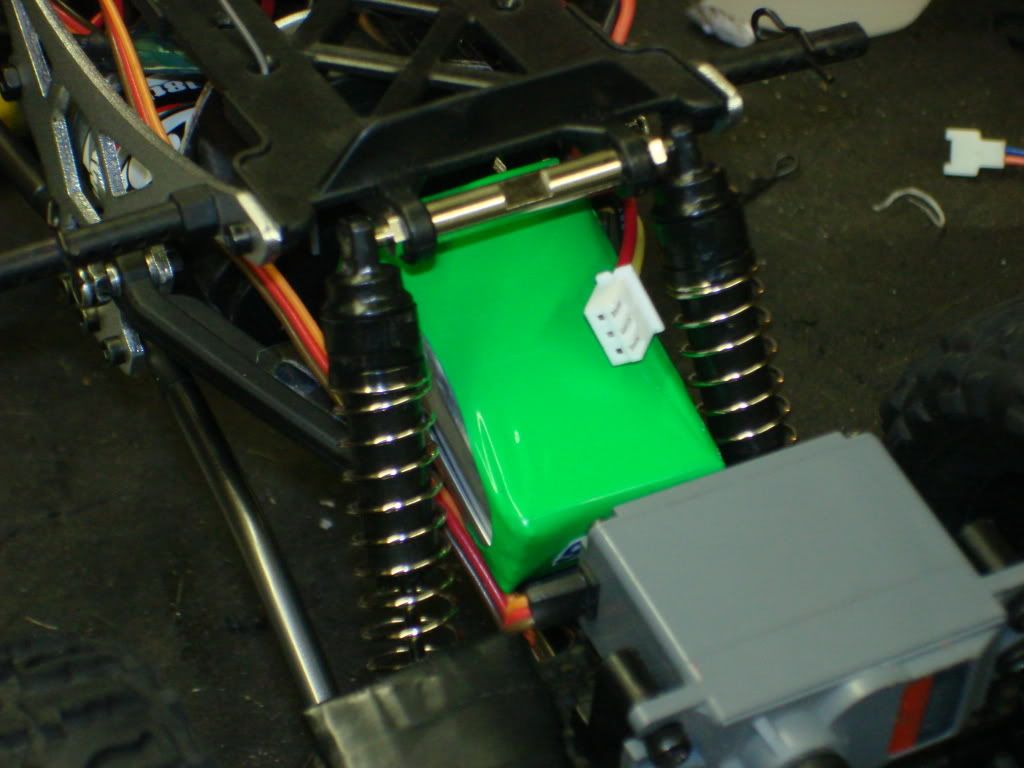

The Lipo fits nicely up front, secured with a little Velcro.
