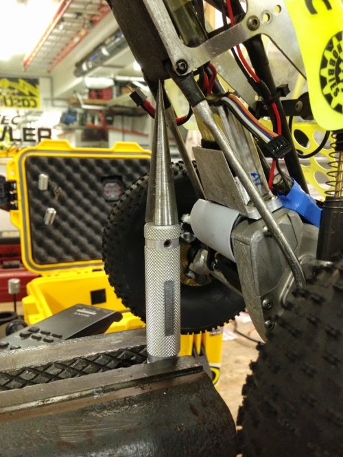

I buttoned it all back together last night. Still have not put it on the rocks yet. Her mini-diet (rear axles included) shaved off exactly 3oz, lowered the CG and increased front bias. I moved the shocks off of the chassis by 0.080" on each side to get a little more linear shock rate during twist. She's a plump 4lb 13oz now. New ESCs will harvest another 0.5oz vs the current ones and she'll be good to go for a while. Tonight I drive.

It almost balances from the tip of the battery plate so you're not too far off of the mark.
Put down three packs last night and it surprised me how easily and consistently (thrice don't count) it traversed some of my most difficult resolution points. Need 10 more packs under variable temperatures (heat) to be sure, but I'm seeing all upside to the changes. Not often does this happen. Most changes are usually a compromise. Verdict still out since I'm a skeptic.
