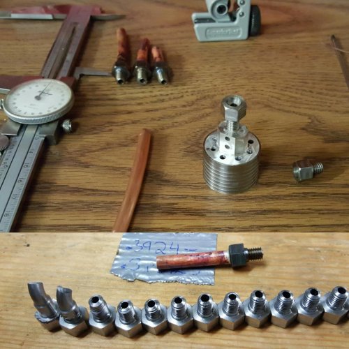

Today was making tooling for my tools with said tools. Next few jobs have tough materials and boring work, so we needed to step up our cooling game. Made some m6 and m10 threaded bungs with a lip to braze in .25" copper tube. Gotta route that coolant close or through the tools, and the 6mm line and fittings is hard to find. So now everything is .25" compatible.
First two bungs didn't make it. Got better from there.
Material is 303 stainless. Using my braze alloy and Flux it attaches easy to the copper.

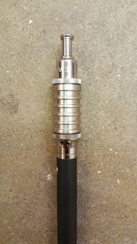

When you have a machine that can make stuff, people want stuff made. Locals pestered me into making stainless replacement parts for a popular vapor pen, the yocan w3. Im told the glass sleeve breaks easy. I took it on myself to make it look good at the same time. Machine was tooled up right and I just had to make a program, one of the easiest parts ive made from start to finish.
