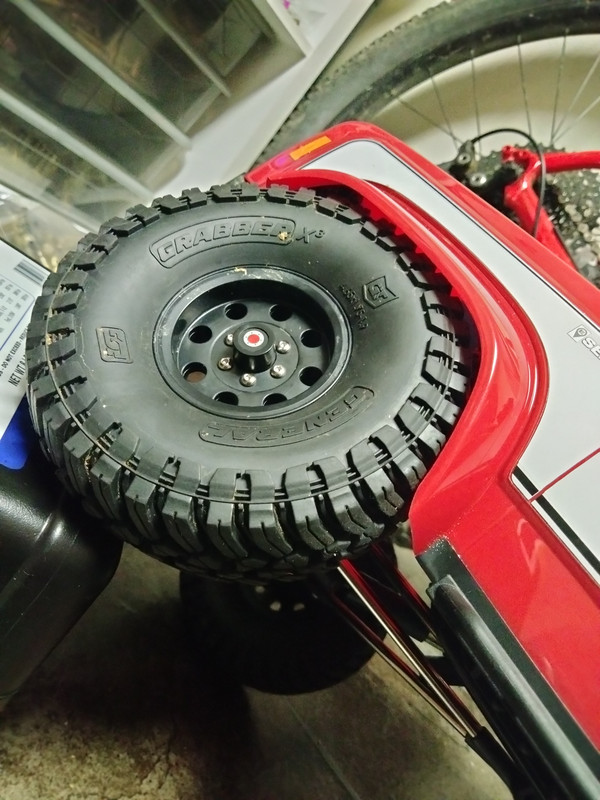

decided to cut the foams a bit to give me some more sidewall flex. stock foams seem a bit stiff. went at it with a serrated knife and sharp scissors for the edges. i tried one and it gave me what i wanted. drivers side is cut foam and shows the flex i want. pass side is stock.
i didnt finish the job because these lil chromed screws suck. tiny head, didnt fit the allen key well at all, and almost stripped one out. Im gonna go to true value/work and get some good SHCS and either retap or use nuts on them. these gotta go either way. otherwise i do like the way they are put together.
-ok, i was able to use 4-40 SHCS and simple use a drill press/vertical drilling arm to punch a 4-40 thread perfectly straight through these. I did 3 at a time, pulled old bolts, then did the other 3. After this, they went right in. good length too. i love these wheels and how they assemble, so now they are super easy, and all black.
