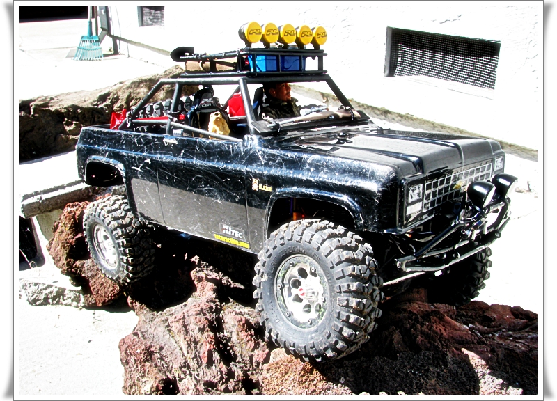

Well..here's ma' Honcho RTR with fabbed interior.
-Axial Honcho rtr
-4-linked rear-axle
-stock electronics
-Carson truck 972kv 540. Torqey as heck. runs forever on 2400mah. Say, an hour, or more.
-Ansmann aluminum dampers. 3 holes piston, 200wt. silicone oil, stock springs.
-Trusty, 5 year old Sanyo 2400 mah Ni-Cad (!)
-Fabbed interior, shovel, axe and towing cable.
Interior details from 1/12 doll-house accessories. Chairs&Dash are fabric -covered balsa. light, strong ,easy to work with.
Interior tub is 0,5mm ABS-plate. (heavy)Interior is easily removed because of velcro.
overview
rear with fabbed accessories
ubiquitous flex-shot
"Oy! Where did my car go??"
Interior doodah's
Scratch-built dash and steering-wheel.
Velcro positioning 1
Velcro positioning 2
Looks pretty convincing...
Positioned on correct height ,tnx to endles possibilities of velkro ;-)
If You'll look close, there's some nice alu tid-bits.
I have to re-paint the figure though, haste&wobbly hands don't mix.. :P
Thnx for looking.
