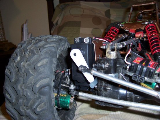

So far for the year I am in 2nd place in the points, with a 1st, 6th and 4th place finish. A few changes......... 18.25" wheelbase and huge freakin servos, and 5 sub c recever pack, I have 7800 mah of onboard power now, no need for lead weights..............

Hey Jeff, you may want to wrap some electrical tape or something around those battery wires in pic #4. Rocks like to snag those right off the cells. Been there, done that....now my cells are wrapped up.

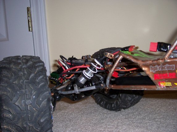

Do a little more fiddlin with my setup, right now its got 2 mamba maxs from the crawler store, cvd's alos from the crawler store with my own aluminum hexes, went with sub-'s for an rx pack and a 4000 mah 3 cell lipo from holmes hobbies, and also 2 crawlmasters. I will be switching to the new bm16's shortly. Also I changed to revo shocks, much better, the suspension is smother and more stable than with the maxx shocks, expecialy the front. This rig is about to be retired, to make way for my new rig..........The Highlander"thumbsup"

It's the oil that came with the shocks, as for the travel its about the same, with the shorter shock it gets moved up the suspension link to get the same ride height, so it has to stroke less at the shock to get the same movement at the axle. I will probably swap to jato springs in the front, I bought some, but I can't find them........
Good greif I tore the house apart looking for these springs, they were in the trash outside.......... anyway the jato's work much better, the revo's felt good, they were just to stiff for my driving style. The fronts are 1.1 lb and the rear are .9 lb.
