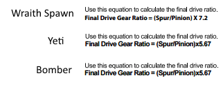

John - I think you meant the stock Bomber is the same as the Yeti - with the transfer case and all.
From the respective manuals:
But nonetheless, that is a great explanation of the tangible differences in KV, thanks "thumbsup"
Re: Puller Pro Brushless 4 pole Sensored motors- Lays down the Power!
The final ratio is the same from wraith to Bomber (as I understood reading through the manual), but the transmissions have different internal ratios to get there. The chart you posted has diff x internal ratio, and multiply that by spur/pinion to get final.
Ah, I found the discrepancy - I was using Wraith Spawn ratios which differ from the original Wraith (32p vs 48p). So John is right (of course!) the Bomber and Wraith (non-Spawn) ARE essentially the same ratio...
Bomber: 64/12 x 5.67 = 30.22
Yeti: 64/16 x 5.67 = 22.67
Spawn: 56/12 x 7.60 = 35.47
Wraith: 80/20 x 7.60 = 30.40
And I found another typo the Spawn manual :shock: The tranny (52/20) and diff (38/13) ratio is 7.6 NOT 7.2 as published. Axial needs to hire a (better?) proofreader.
