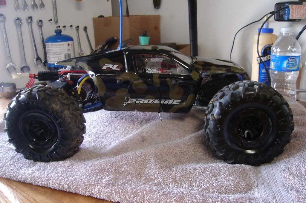

Ahhh, I see. Thankyou sir. What is the average degree of articulation? Right now mine is the rs10 xt. So the 4 links already done, I put on the 30 deg. bent links as well. I've got about 85 deg as it stands. The only real issue I've had is the back end wanting to wrap around when using the 4ws in a bind. I've bent link ends in two. I'm not sure on my shock setup either. Here's a pic, any advise would be greatly appreciated.
here's one to show the articulation that it has now.
