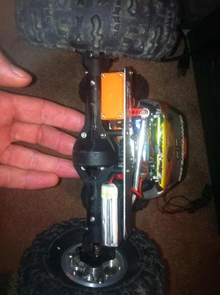

Ok, I've read through all 15 pages, good stuff. I got lost in a lot of the motor/ESC stuff, but I'm not at that point yet. I bought a very modified LCC and I'm trying to get the chassis all solid before messing with electronics.
Questions:
Upgraded hexes? What fits that will replace the factory plastic hexes?
What's a good, small battery with decent runtime? I'm currently test running it with a 2S stubby pack, but the chassis has limited room for a battery. I'm running an Axial AE-5 ESC and one of three motors (haven't figure out which is best out what I have) Axial 27T, RC4WD 45T or a Titan.

Well, if you could see what I'm working with, you'd understand. It's a cool truck, with potential, but it's passed through several hands, so now it's a little rough. I plan to get it working again, 100%. It had those dopey servo horn shock extender things.
