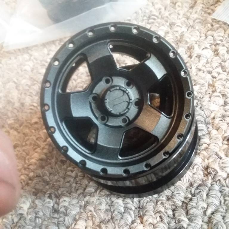

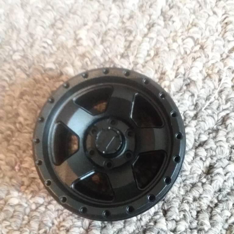

Here are mine. I didn't mount them to anything. The quality is much better in person than what I expected from the photos.

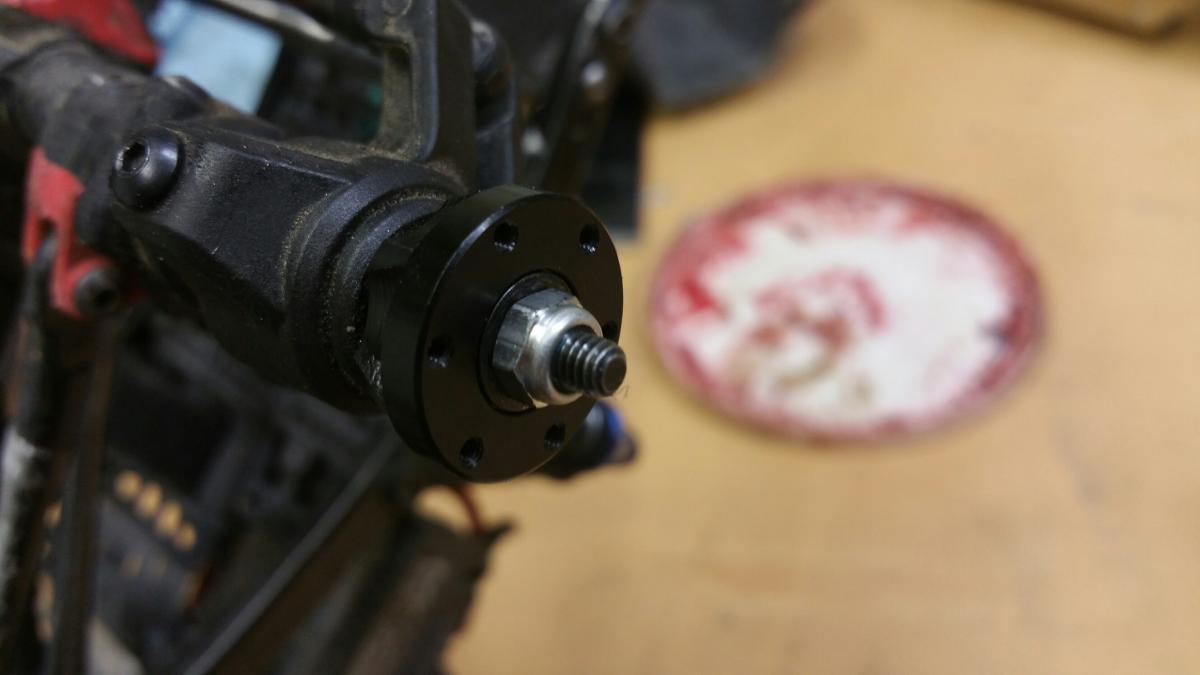

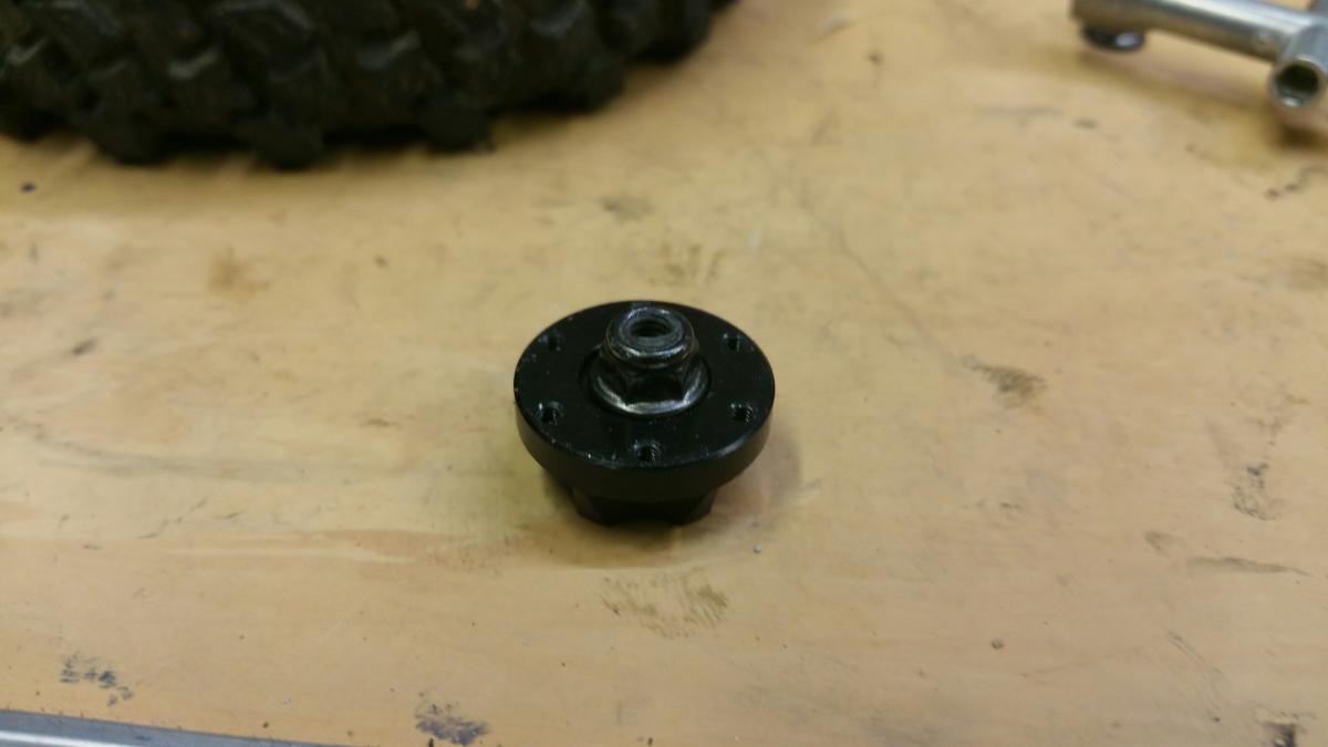

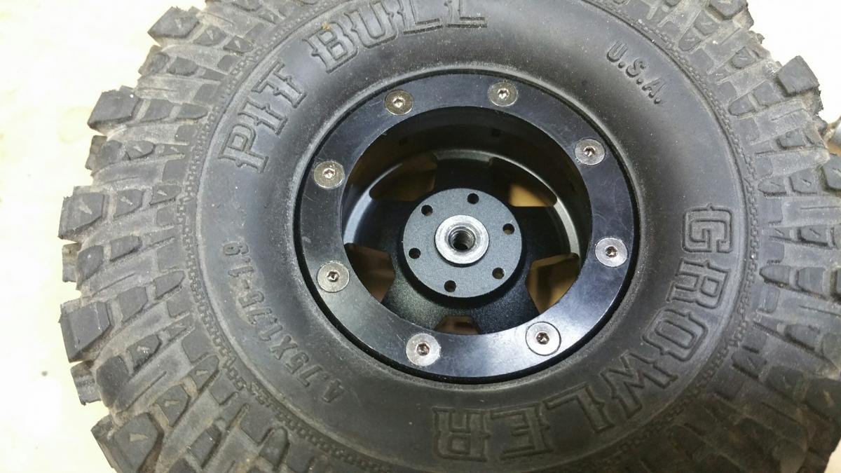

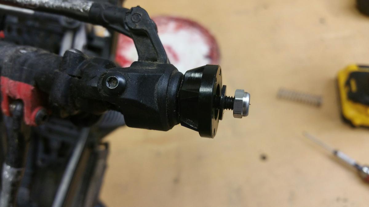

Update, got my wheels mounted on scx10.2 for now. I did find problem in my case. The countersink where the hex nut sits is just a touch not big enough. The wheel doesn’t quite sit flush, rocking a bit. Pics show the nut washer combo I needed to do to fix it.
