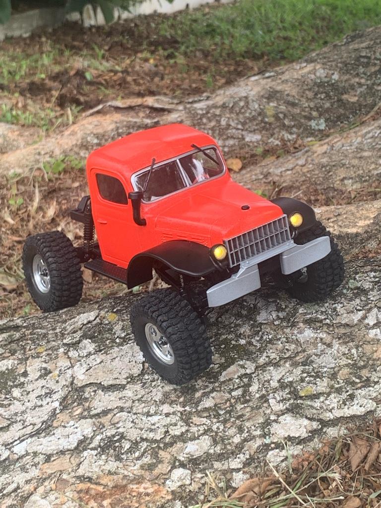

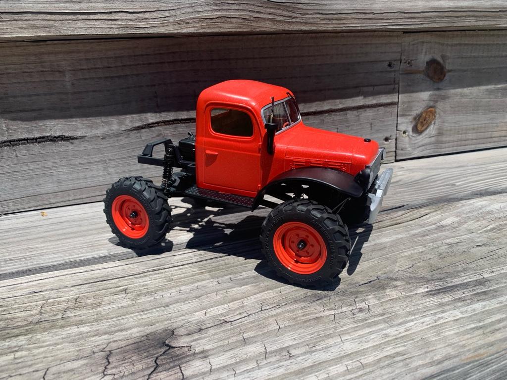

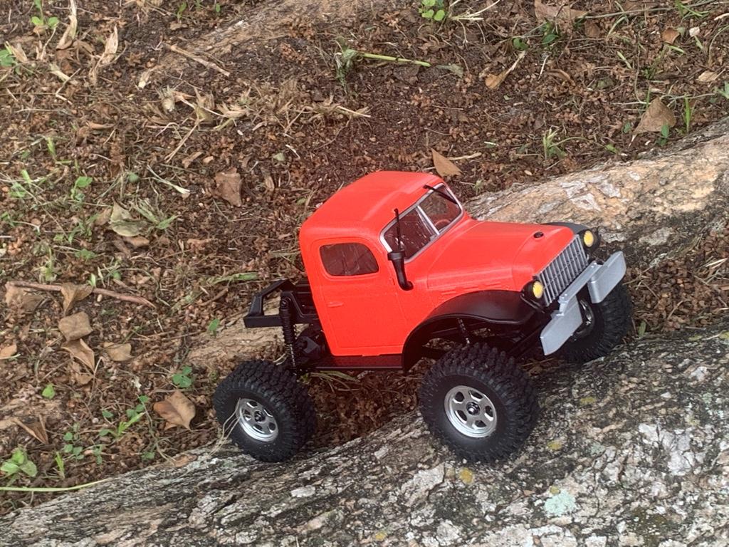

This has to be the smallest crawler I’ve run, But it’s a big league performer.
So I read about it and was intrigued. Surprised that I could get it (in red)in two days from Amazon. So I did, and came RTR. Why Doug? Well the Chinese are known for knock offs, and I guess translation was bad……
I did try it with stock shocks…… hmmmm
Great rock bouncer, but the shocks come dry, but a complete o ring set is included. Building the shocks was a heart attack, until I found the cap I launched 10 feet. Green slime 6 drops of 30w and the shocks worked!
No the shocks don’t leak, and I’ve got the metal portal gears coming in.
No

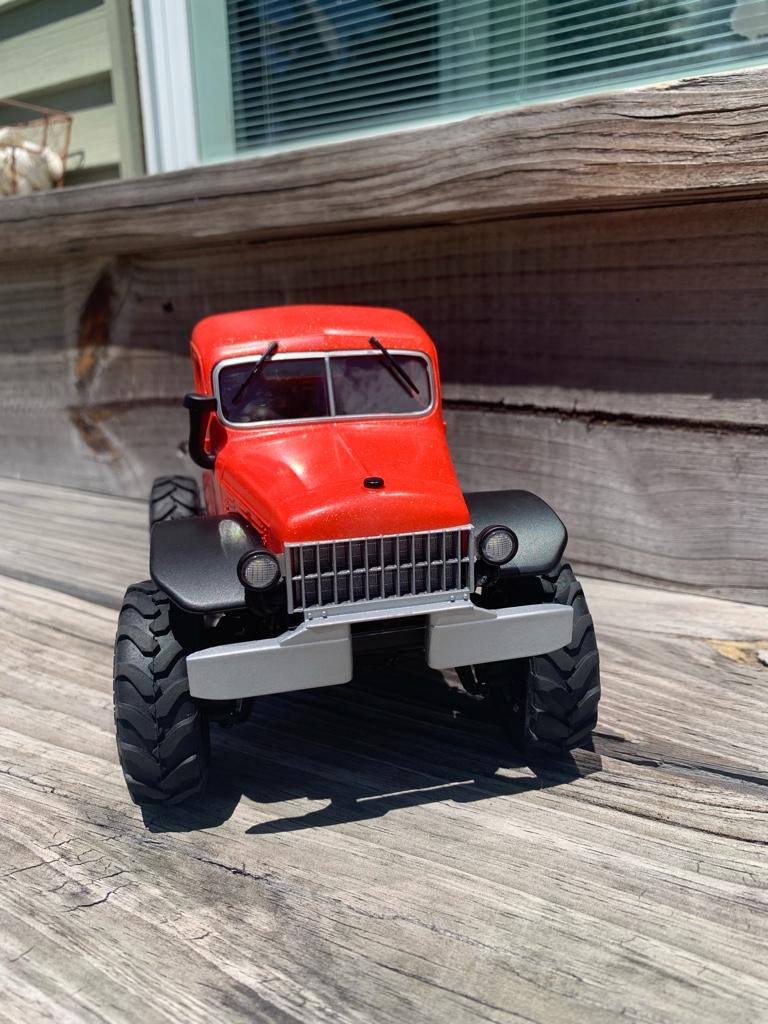

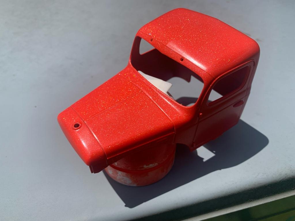

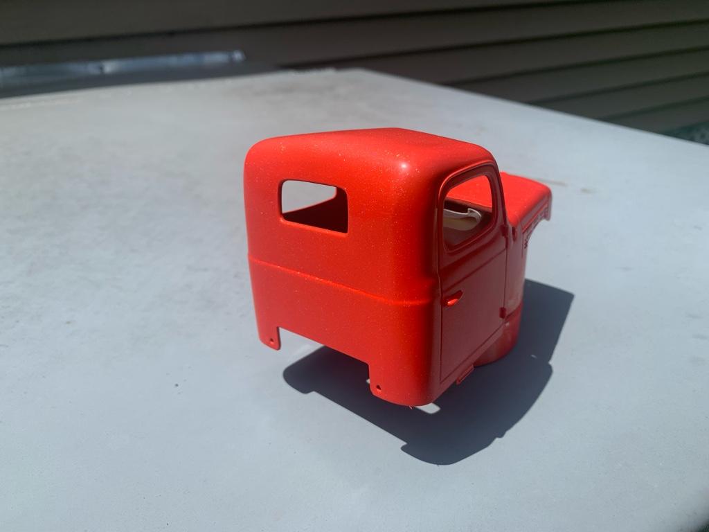

I can’t leave things alone. They also don’t come in sparkling orange. Standard Tamiya TS31 bright Orange, topped with PS33 lamé flake, then buried in clear, waiting for it to cure so I can polish it out. Also painted the stock red wheels, but may do something different there.

...In your previous post, was that the original red?
It looks darker than in the "stock" pictures online.
I think I can answer that. The pre-release photos show it being an apple or 'firetruck' red, just like the other primary colors...
but every real photo from an actual owner seems to be a deep metallic red, maybe "candy apple red" depending on the lighting.
Man, that looks pretty damn nice Mike!!!
Nice choice of color "thumbsup"
Yes, as noted above it’s closer to metallic maroon, but wheels red. I’m done with the touch up, amazing what detail painting does. This almost looks red, but it’s bright Orange

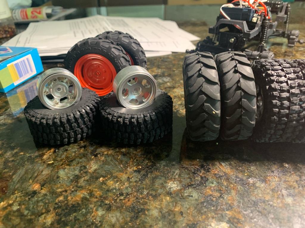

what size are the stock tires and wheels? They are obviously larger than 1.0's.
Are they 1.2, 1.55, 1.7's, or some other size rendition?
Rims are 1.4ish tires are 60mm tall.

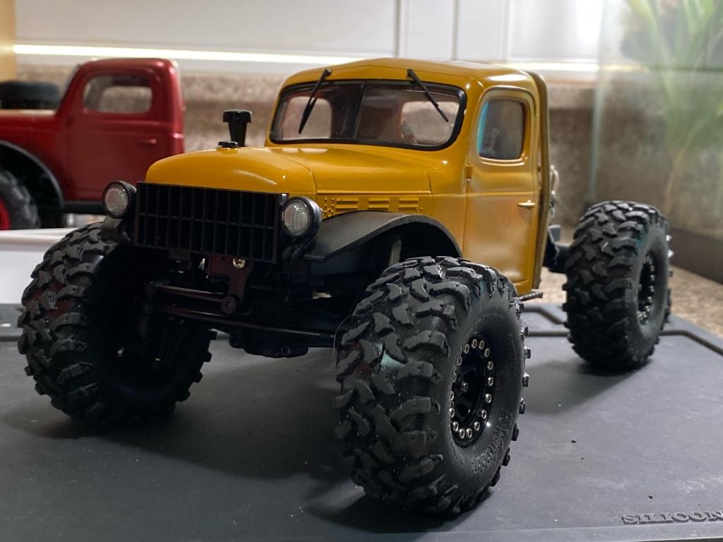

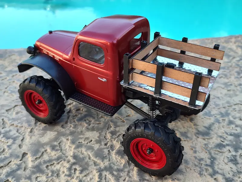

Dig the color Mike!

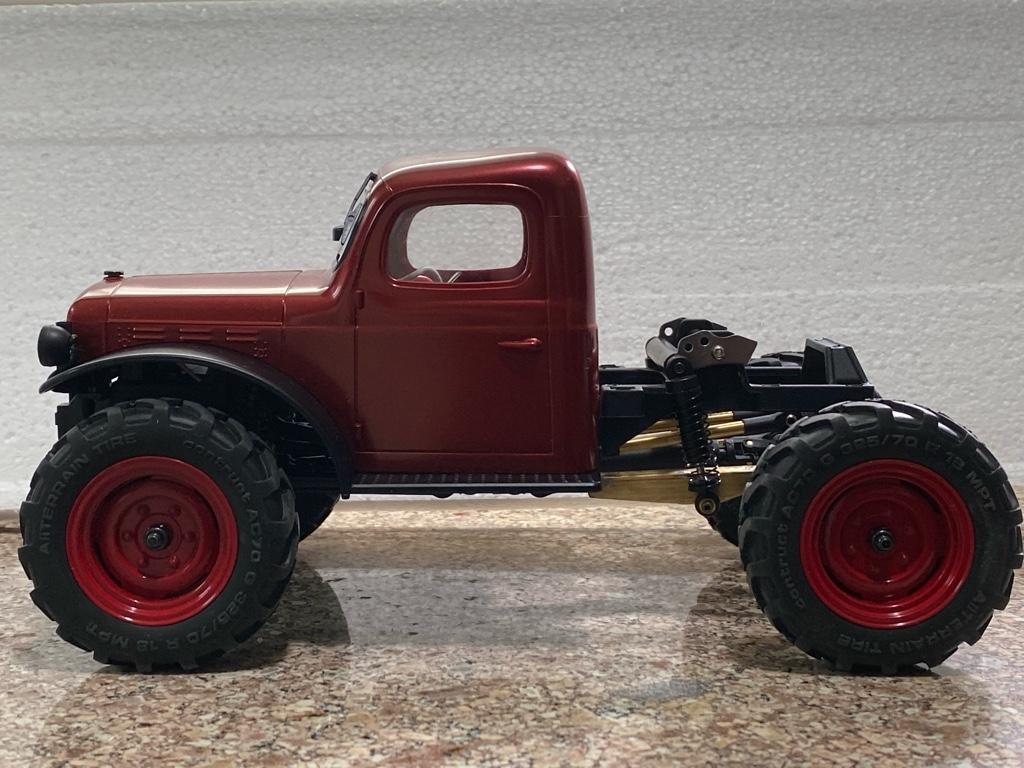

I really wanted to keep that awesome cage from fms but my soldering gun had different plans.

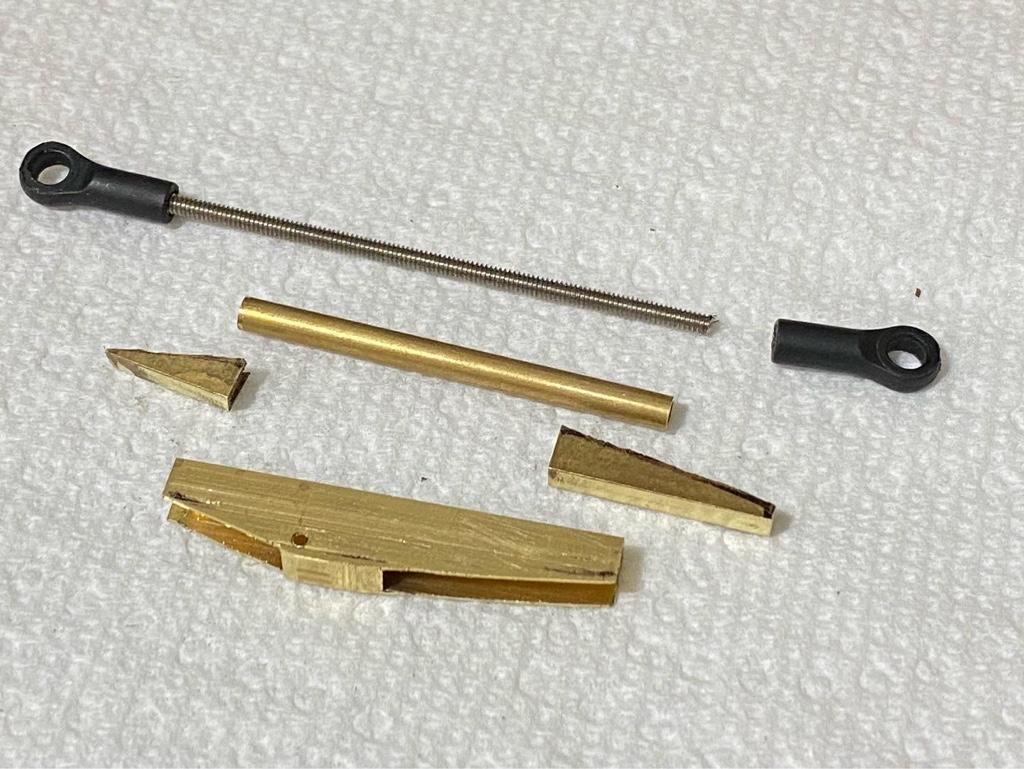

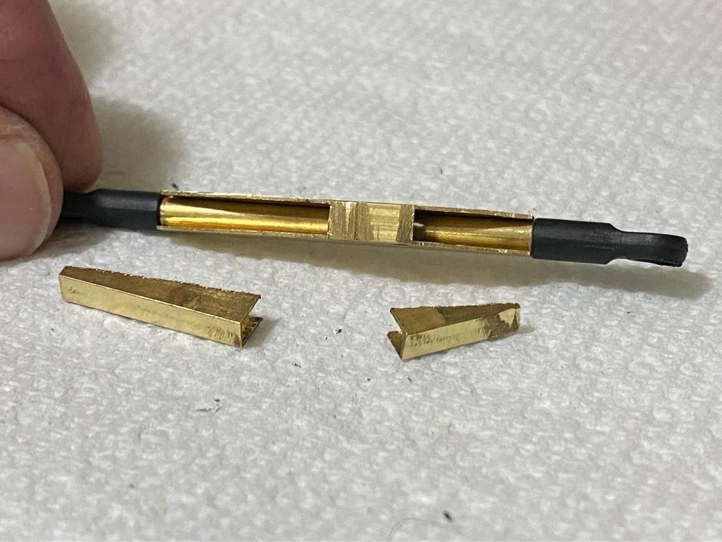

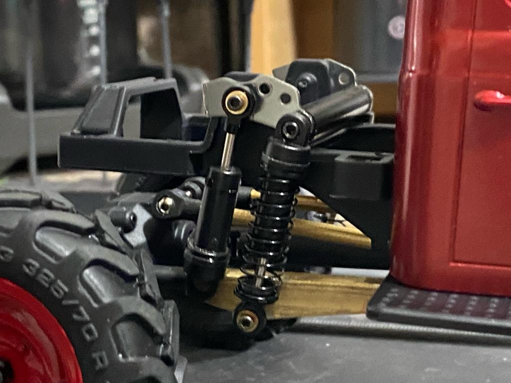

Also got started on number two stretched the rear out 16mm via brass trailing arms and working on a dual shock setup. Shooting for go fast with some air time type build.
Man that rig looks good with your detail work! :shock:
Too bad it will need wider hexes for those wheels.
With the portals and dropping to the 1.0 wheels, I am sure a few of them will have fitment issues.

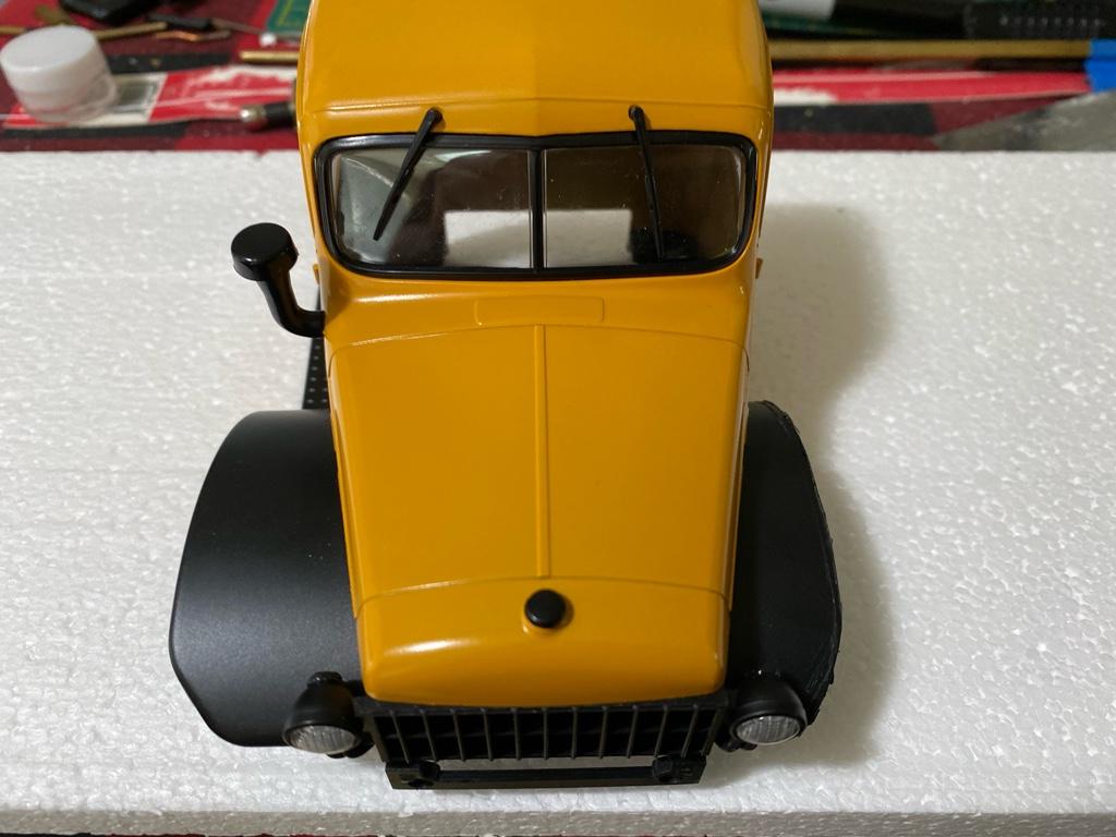

The detail painting was quite easy as everything unscrewed and minimal taping needed. Quick wash , I did prime the body before paint, nothing but Tamiya rattle cans
