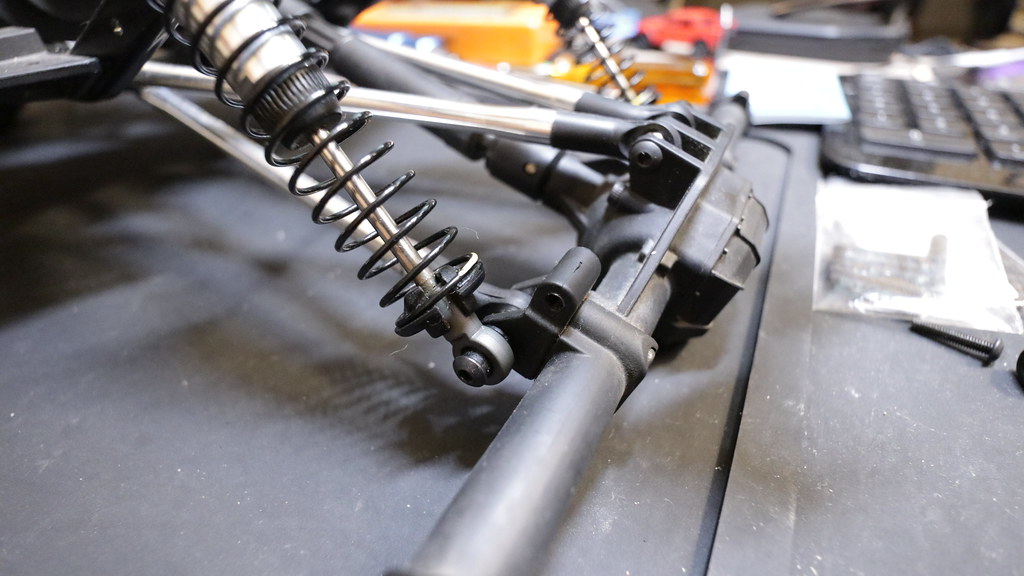

I moved the lower shock mount location from the lower shock mount position to the same position as the lower links so that the shock angle wouldn't be as "laid" down as it first was when I put the BOM cage on. It's now at an acceptable angle. This might also be useful for those of you that want to run longer shocks.
Here you can see where the original lower shock mount position is versus the new location.
A nice bonus to this change is that I have somewhere to mount a swaybar link should I decide to use one.
