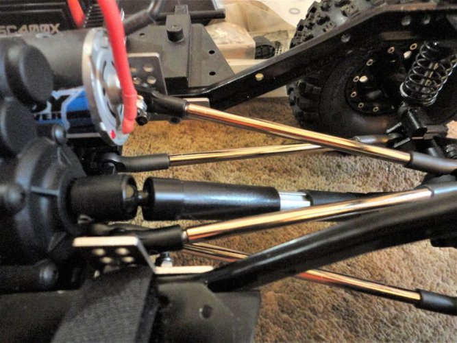

Here's a couple from me. Modified CBE link brackets and short Revo ends to gain some anti-squat. And a recycled Axial battery plate on the sliders.

Yes, today. I have the links at the lowest position on the bracket, but plan to move them up another hole. I tried a line that I failed at before and it has made a difference. One more hole up and I think it'll be dialed. This is just a random picture from today.

The link risers can also be mounted to the outside of the chassis, but you'll need to clearance the side plates. Both ways achieve the same results.

The CBE risers I used had to be placed further back on the chassis to clear the motor and skid. The short upper rod ends brought the axle back to a stock position. You may have an easier time with your own custom made brackets. I used what I had on hand. Definitely worth the small effort.

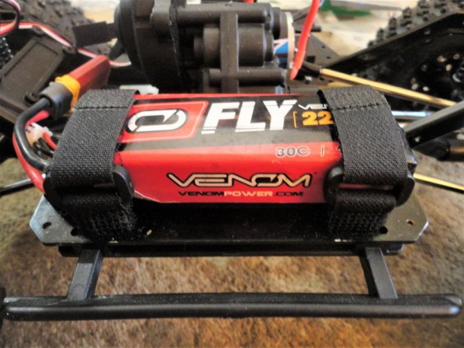

I was looking at the battery tray thinking it could sit lower so I did a bit of tinkering and came up with this:
Lowered battery tray, the battery is as low as it can go in the stock location now. Its basically sitting on the frame rails now.
What I did was notch the stock battery tray for the chassis rails. I used the ridges next to the holes as a guide of where to cut and the battery strap notch for the other cuts, and the angle I did freehand with a razor. The other cuts were made with a fine toothed hand saw.
Flip the battery tray mount point/crossmember upside down so its offset downwards instead of up.
Notch the battery tray to clear the driveshaft.
Removed the ridge that runs between these holes so the battery tray could sit on the mount (this is probably not needed as I did shim this up a bit after)
With all that the tray now sits like so, with the chassis rails sticking up a few mm.
I printed up some spacers to lift the tray up 2.3mm
Put them in these holes
and that raises the battery tray up so its now flush with the chassis rails. Stock screws can be re-used.
I though about designing a new tray to 3D print but hey why not re-use what I already have.

my battery is just barely too big (currently not sitting flush in my enduro), so i might try the extra ascender battery tray i have laying around as my batt fits in those perfectly.
this is great, maybe i will buy slightly smaller 3S packs and do this.
That mod should work with the larger tray too I assume. I think the RTR included the big and small battery tray too right?
