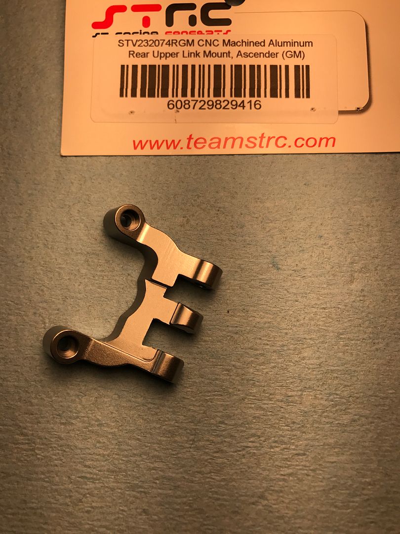

Bought STRC rear axle upper link mount to check it out and maybe use as part of a lifted and rearward mounted setup on the axle. Nice looking parts, I bought gunmetal color but they have black and silver too.
Part number: STV232074RGM, in stock at RPP Hobby:
https://www.rpphobby.com/product_p/sptstv232074rgm.htm
