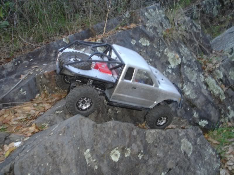

Crawled yesterday to test it out and works even better than before, slightly lower cog helps. Put the stock X brace back in the bed cage, it just looks better to me. :)

Yes the tires are on the rock...made the sidehill. 8) Cut up kit Flat Irons with stock foams and a little weight. :)
Stock aluminum front lower links are becoming self bent high clearance links after the last outing, need to get something stronger in there!
