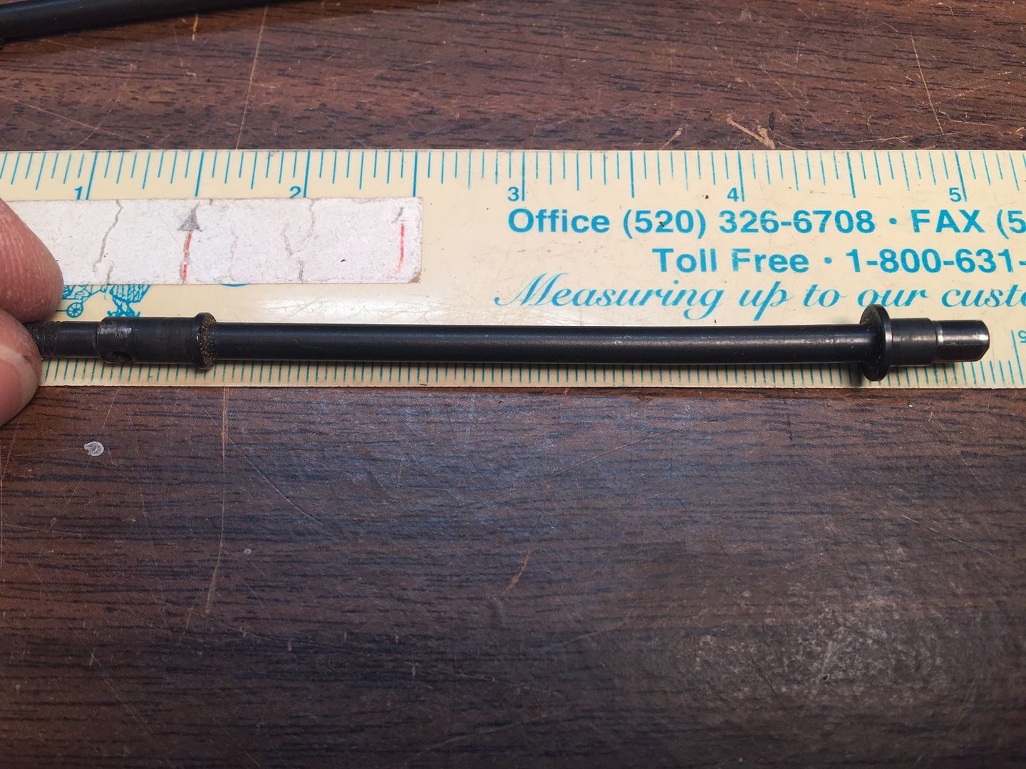

Front and rears done.
Bent rear axle shaft, hard to photograph how bent it really is.
Switching to WB8s on this truck now lol

yeah that's probably what did them in, i was confused because other wise the axle shafts are supported inside the axle housing.
and yes it was a little red (and very rusty) 87 2wd toyota, it was my friends truck, we where mucking around in a parking lot and he accidentally rolled over it (passenger side didnt see it) only bent the rear axle shaft at the threaded end and broke a front steering knuckle. that was it (and everything on the scx10 was stock believe it or not!)

Yes, the stock plastic lockouts have not broken or cracked, but they are not very tight on the housing like when they were new. Wow, you got lucky lol!
