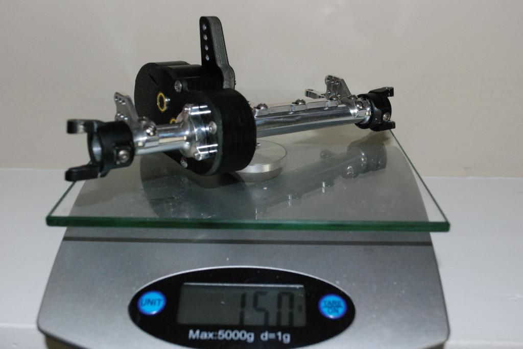

Front Axle:
Classicut Case
Classicut Battery Mount
Big Ron Electronic Mount
Drilled Gears (Rcbro Machined Gears next)
Vp XR Bent Tie Rod
Vp Wraith Drag Link
Vp 8* Chubs and Knuckles with Big Bearing Mod By Jeepin Doug
Rcbro Tubes
SDS 300's With Fresh Rebuild
SDS 3rd Gear
