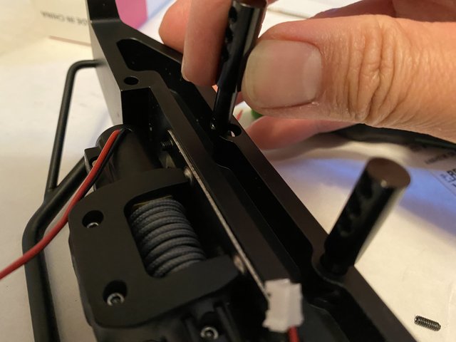

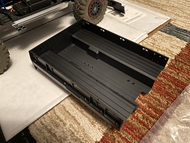

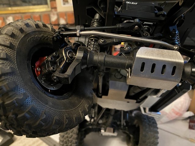

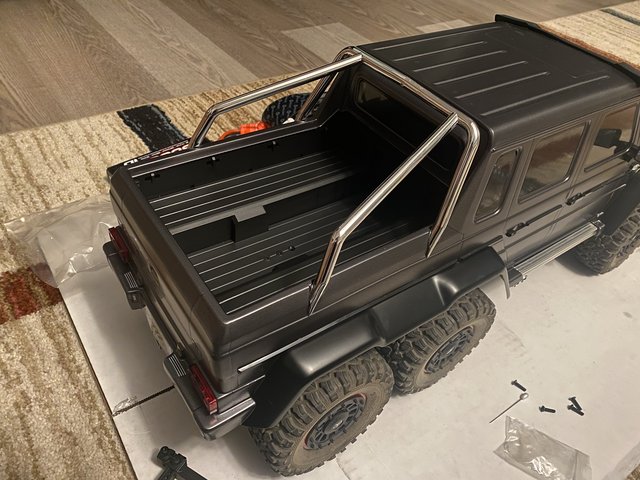

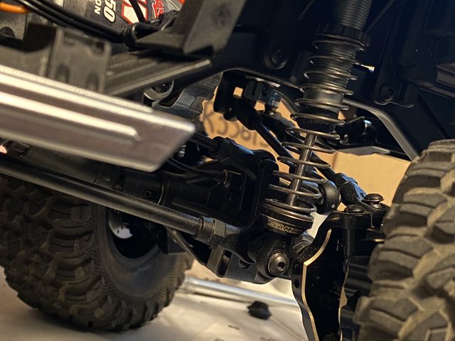

Installation of the brass components were a breeze. Used some Mobil 1 synthetic grease during the install. The Hot Racing offset tie rod was a necessity and I’m glad I got it. Eliminated the rubbing of the factory tie rod on the differential cover at full lock. The truck bed I bought from eBay fits perfect. No complaints on it whatsoever. It fits like the bed came from the Traxxas factory. Highly recommended to turn make the TRX-6 more of a scale appearance.

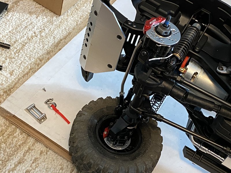

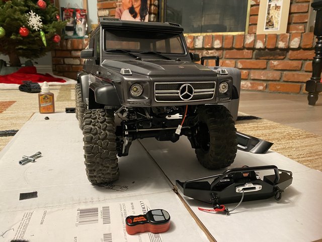

Next: winch/bumper mod

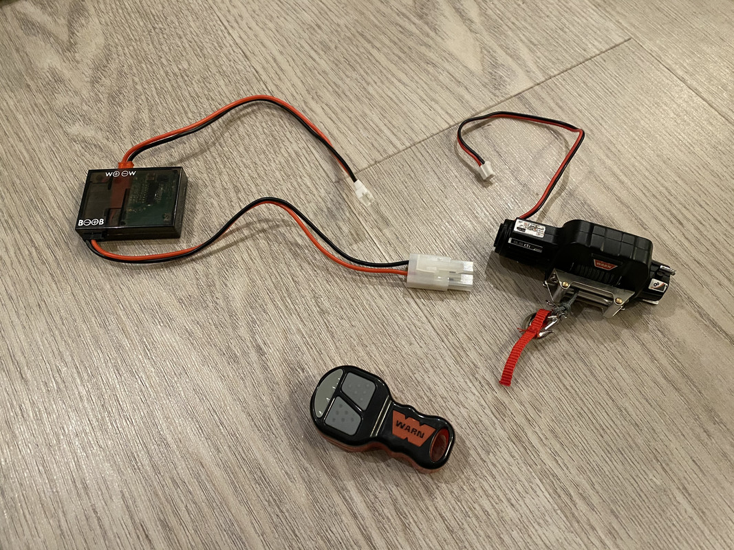

RC4WD Warn 9.5ct winch
RC4WD Warn wireless controller
RC4WD front bumper
RC4WD Warn fairlead
RC4WD Warn shackles
Scavenged a 9v battery connector from an old smoke detector for a dedicated power source for the winch.
Continuing my winch/bumper mod...

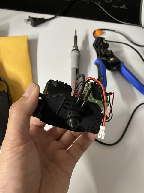

I singled out a 9v battery holder from a row that holds four I had bought from Amazon. Also bought a cheap "scale storage box" to waterproof/dustproof the wireless winch controller with some silicone gasket maker. Here's how they look like:

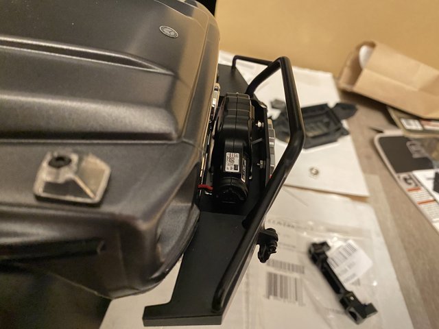

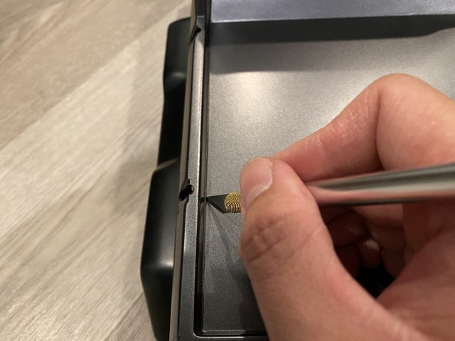

I carefully cut away the front bumper. Making the cut at the front of the fender flares on both sides to match was not easy, but I think I did a pretty good job :D
Soldered on a waterproof on/off switch externally for the battery. This way, I don't have to remove the body to plug/unplug the battery every time. The switch will be hidden on the undercarriage right behind the front bumper.

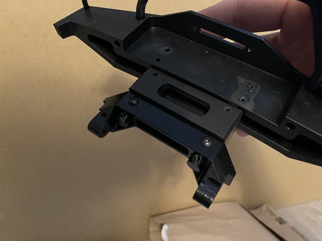

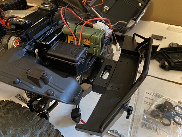

The mounting posts on the RC4WD front bumper made it sit too high or too low to the body. My friend with fabrication skills made me an adapter out of a solid aluminum block:

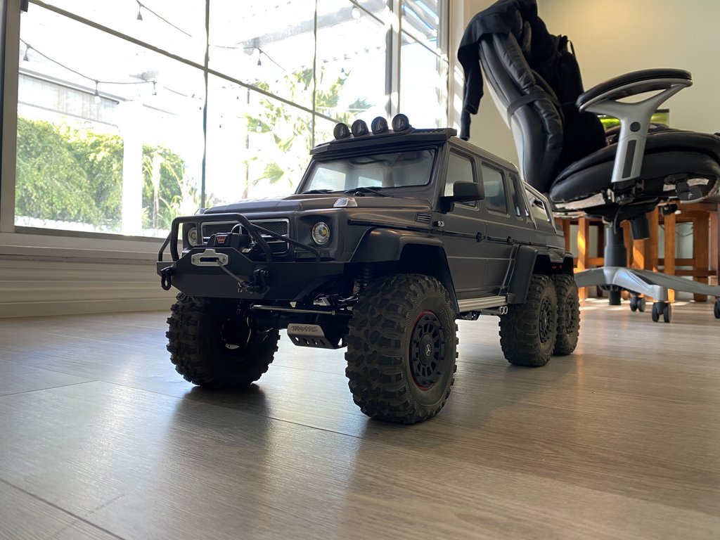

Fitment is PERFECT and ROCK SOLID! Used the winch to pull my office chair. No flex on the winch or bumper. Form and function like it was made at the Traxxas factory! :thumbup:
Damn that looks good. Great job, changed the whole look of the truck.
Thanks, Phildirt! I’m more than satisfied to how everything turned out for this truck. I didn’t expect to go this deep into upgrading it from when i first got it as a birthday gift. My first r/c truck, may not be my last, though :)
I'm always envious of someone that has a vision and executes it/ends up with something so clean it looks like it came that way out of the box. My 'builds' always end up looking like I changed my mind halfway through lol.

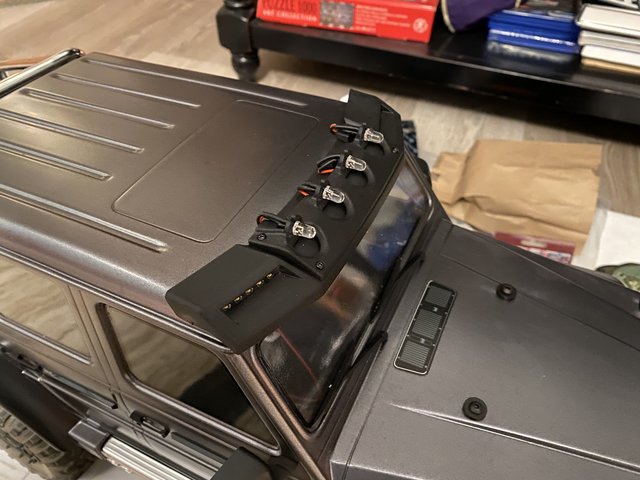

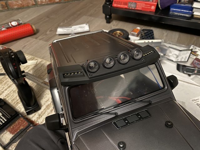

Hnoroian: The lights I used for the roof lights are Team Associated XP rock lights 150mm. I connected it to a Y-harness via the receiver box.
Scalelifenewbie: Thank you! Yeah, I couldn’t stand the look of the factory front bumper.. I had to be brave to cut it out. I’m glad I did it. Looks good in pictures, but even better in person!

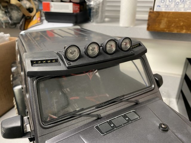

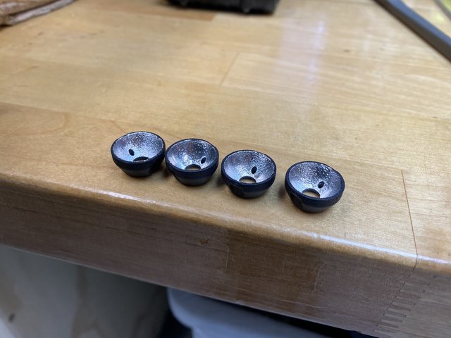

The roof lights were too dim when I wired it to the Traxxas LED power supply. I re-connected it to a Y-harness to the receiver box for a 6v power supply and now it is where the brightness should be. I also used a liquid chrome marker to plate the four individual light bezels to enhance the output. Success!
Before:
After:
