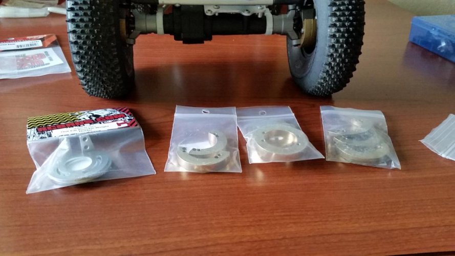

As always, RCBros shipped out my knuckle weights ridiculously fast. I think the shop is in the middle of a move right now, and they were still here in 4 days.
Very nice.
My usual practice is to tap them to 3mm upon arrival; but the tap just spun free in these weights.
I don't know if they've started going 3mm; but I'm pleasantly surprised.
The weights I used for the shakedown run were stolen off my sportsman rig.
It's time this rig had it's own weights.
I really have no idea where I'm at on weight, or bias.
I got a handful of goodies and just mocked them up for right now.
Got one extra half weight on here.
May be useful, maybe not.
Honestly, I'm waiting for the plastic gears to show.
They'll be in the rear, for sure. Maybe both cases.
Then I can really establish what this rig needs for knuckle weights.

As far as I know, RCBros weights have always been tapped 3mm.
At least for as long as I've been buying them.
That's strange.
3mm wouldn't thread in the first couple sets I bought, 4-40 spun in smooth.
Just figured that's what they were.
It took 'some' effort to run the tap into those, these spun free on the tap.
