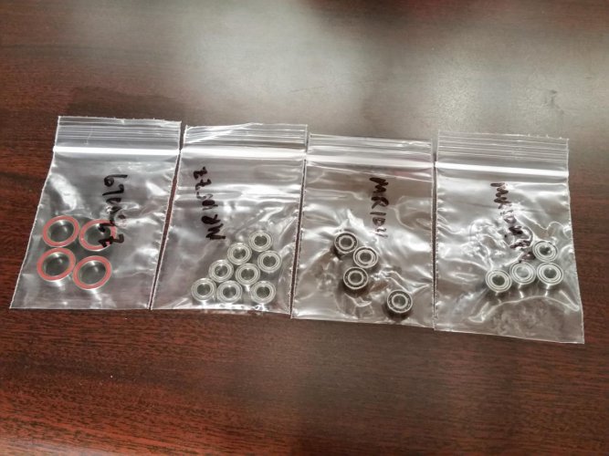

Bearings for the cases came from RC Bearings.
I figured a new rig needed a fresh set of bearings to have a clean start.
The bearings at the ends of the tubes were just a bit snug on the Axial shafts.
I used some scotch-brite to remove the black "paint" or whatever is coating the shafts.
That was enough to get them to slide into place.
Short side shafts have the full 7mm engagement in the locker.
These end bearings will hold the shafts steady in the RCBros lockers.
I think standard Berg shafts use a round tip on the end to center the shaft (might be wrong there).
The XR shafts were only long enough to make a 4mm tang engagement on the long side.
I'm sure it will be sufficient.
Starting with no parts at all, OFNA or Wraith shafts for the long side would afford more engagement; but I already had these parts on hand.
New bearings installed and ready for assembly.

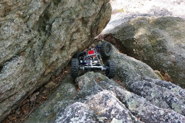

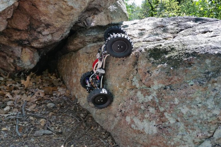

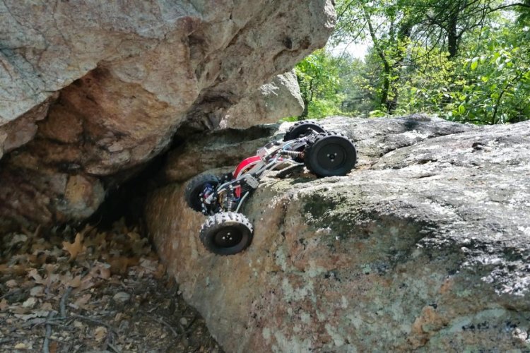

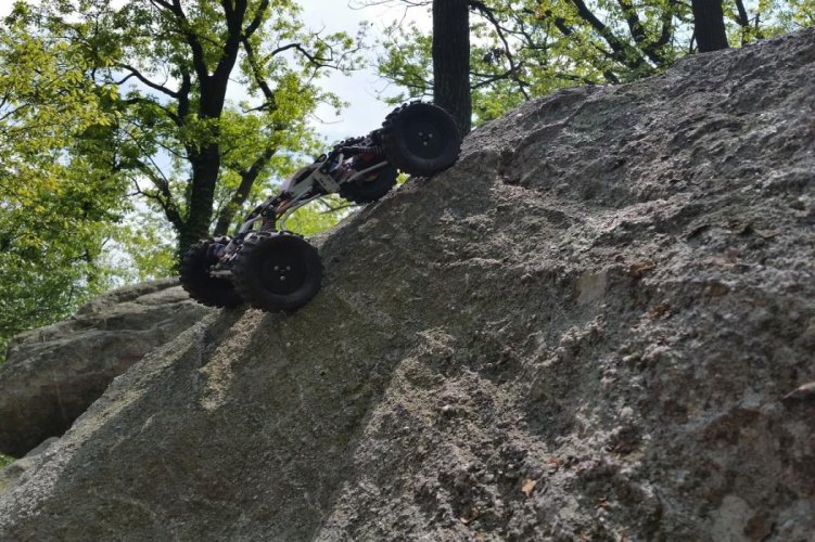

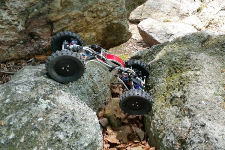

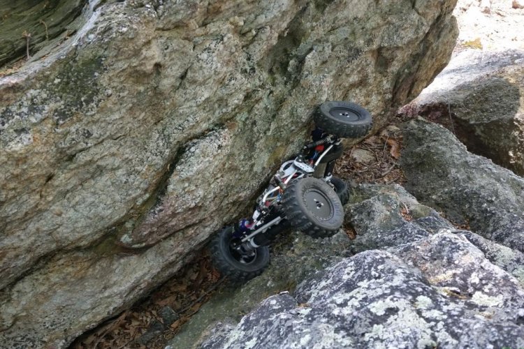

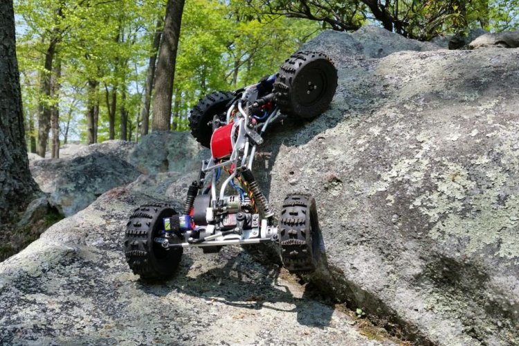

Took the mini super out for a shake down run today.
Soldered the batteries, put oil in the shocks, narrowed some old rover foams and tacked the tires to the rims.
It's not comp ready; but it's test drive capable.
My phone photos won't upload here.
This is my first attempt at resizing pictures, forgive the poor quality. They are not blurry in their original state.
I can't turn the picture quality on the phone down enough to match what the attachment manager says they should be.
Any pointers would be appreciated.
Ground clearance seemed adequate.
Rear steer, and motor mixing can get you out of some very strange places.
I had a lot of trouble climbing steep stuff.
When the rig got loose, I'd try to "swim" the front end around looking for traction.
Between my clumsiness, and not having the radio setup perfectly, I found the rear axle overdriving the front at the worst times.
I just can't seem to keep my right hand from drifting up when I steer, and the rig got way off the line, or went over backwards.

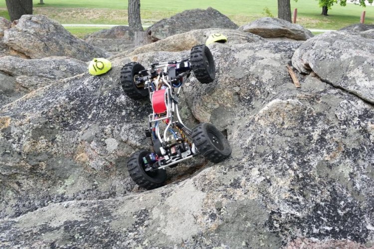

I set up a course; but didn't do very well.
The learning curve on the sticks is tricky.
Clearance on the gates themselves seemed very reasonable.
The rig handled well, I just kept bumping steering or throttle when I wasn't needing it.
I pointed out by gate 6, and got a couple pics after the timer ran out on gate 7.....lol
The batteries last much longer than 6 minutes so that's a plus.
Overall, I'm pleased with the run today.
I need to get the radio to mix the over/under better and get the hang of using the sticks.
Wipeouts, and gate touches were operator error in nearly every case, so I suppose that's no big deal. Just need to drive better.
