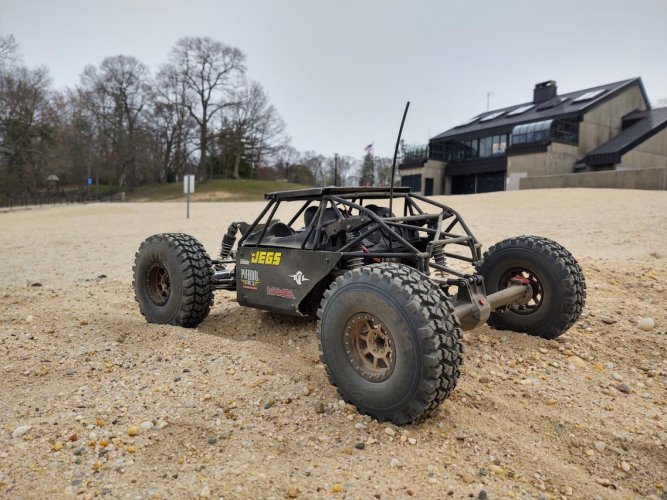

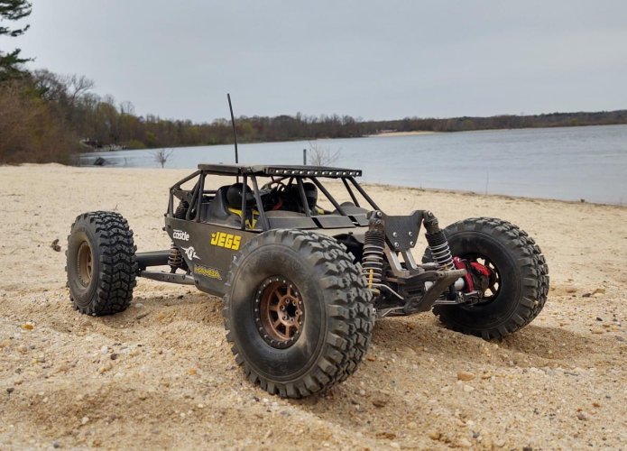

Just some info on another Rock Rey out there. The last picture is front last summer, shows a much earlier stage in the evolution of this build. I only have 2 rc trucks right now so have been focused on running and breaking this truck for awhile now.
I'm really happy Exotek and Afrolucha created some parts for this truck. Both companies produce really well designed products and I look forward to seeing what else they design for the rc market.
Build
Tekin roc 412 hd 3100kv.
Exotek differential cups. Center/Rear locked, front has heavier weight oil, forgot the weight.
Exotek steering system (lazy/not installed yet)

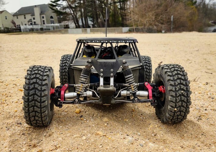

Exotek aluminum/carbon fiber shock tower. The carbon piece was replaced by me and is 5.5mm. Intended to create a front light set and creating a new carbon shock tower with more surface area would make this easier but got lazy. Plate manufactured by Dragon Plate in NY.
Exotek front differential case.
Exotek 3mm steel front skid plate.
Exotek alum. servo horn.
Exotek steel brake disc kit.
Afrolucha front axle sliders.
Hot Racing swaybar kit (stiffest wire used)
Hot Racing steering bearing support (not installed yet)
Hot Racing turnbuckle kit.
Hot Racing rear driveshaft.
Hot Racing alum. Lower arms.
Hot Racing alum. c-hubs.
Hot Racing alum. spindles. I replaced the carbon pieces with 3.5mm plate also by Dragon Plate.
JEC Racing steel lower control arms.
SSD rims, forget which ones. +725mm offset hubs.
Team Ottsix Voodoo U4 tires.
Crawler Innovations hard/tall foams. Have something softer coming soon.
Proline Powerstroke shocks.
Vanquish rear axle.
Incision rear upper links.
Savox 1210 servo.
Spektrum DX5 with AVC rx.
Body panels made by someone on ebay, they did great work.
Currently the rear shock tower is cracked, plan to fix it with a aluminum piece. I don't think aluminum hanging off every piece of an rc mean't for abuse is always desirable. Something should absorb the forces or you risk damaging more components deeper in the interior of the truck such as bulkheads, chassis, etc. I went pretty hard at this build with alum. because I think it looks cool, don't really care if and when it does break.

Thank you and yes good eye, the swaybar was added. It is from Hot Racing, was pretty easy to setup. The swaybar kit includes 3 wire swaybars, all of them have a different diameter so you can tune for your purposes.
Going into this I kind of wanted a high speed U4 type truck that would not necessarily be "race legal," but fun for bashing around. These trucks have a lower CG than I thought at first glance, making for decent climbing capabilities.
Right now I think my foams are too stiff, right now have the Crawler Innovations deuce's wild heavy weight foams (black). They are really nicely made but have the double deuce heavy weight inner/firm outer foams coming. Truck weighs in at 10lbs 1 oz with a 3s 5000 mah.

Does the sway bar kit help a good amount? I’ve thought about it a lot but have yet to pull the trigger.
I was wondering how the swaybar does on rock crawling
That was one reason I had held off on buying it. The rear sway bar on there is so stiff that it almost cuts the articulation in half. I was running without a rear sway bar and it crawled decently but was fairly unstable at speed.
Thanks for the comments guys!
The front sway bar does limit articulation a little bit. The Afrolucha sliders do rub the sway bar, you can see how they have become "polished." Still spins smoothly but after a few runs it is obviously cutting into the new axles more than I would like, will try bending the sway bar a bit to accommodate.
