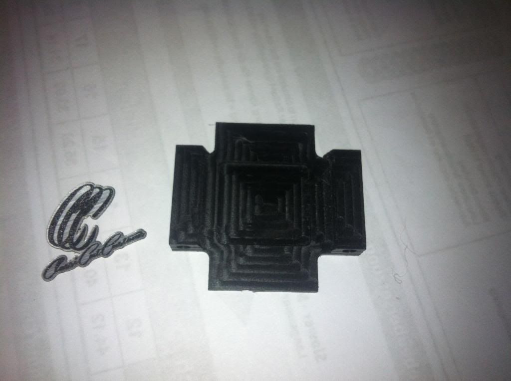

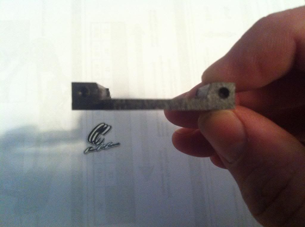

Here is the machined skid. It is clean, tight and to the point.
Only issue at this time is running 60/40 the rod ends hit the chassis.
A little filing and I added a thin shim on the outside of the ball end and it seems to be good.
Looking good there fella...... I had the same issue with the rod ends. I just took a tiny bit of material off the Revo rod end and it moves freely. You also can put a slight bend in the front lowers to make a better angle. I wouldn't suggest a spacer though...... You want to keep the skid and side plate interlocking fully to prevent any racking of the chassis and hence causing the lowers screws to back out. Ever experienced that problem?
Thanks Barry. I think a bind is in order here. The shim / spacer is just a washer to give a little room but if I bend the links it won't be needed. No never had issues with skid screws backing out.
