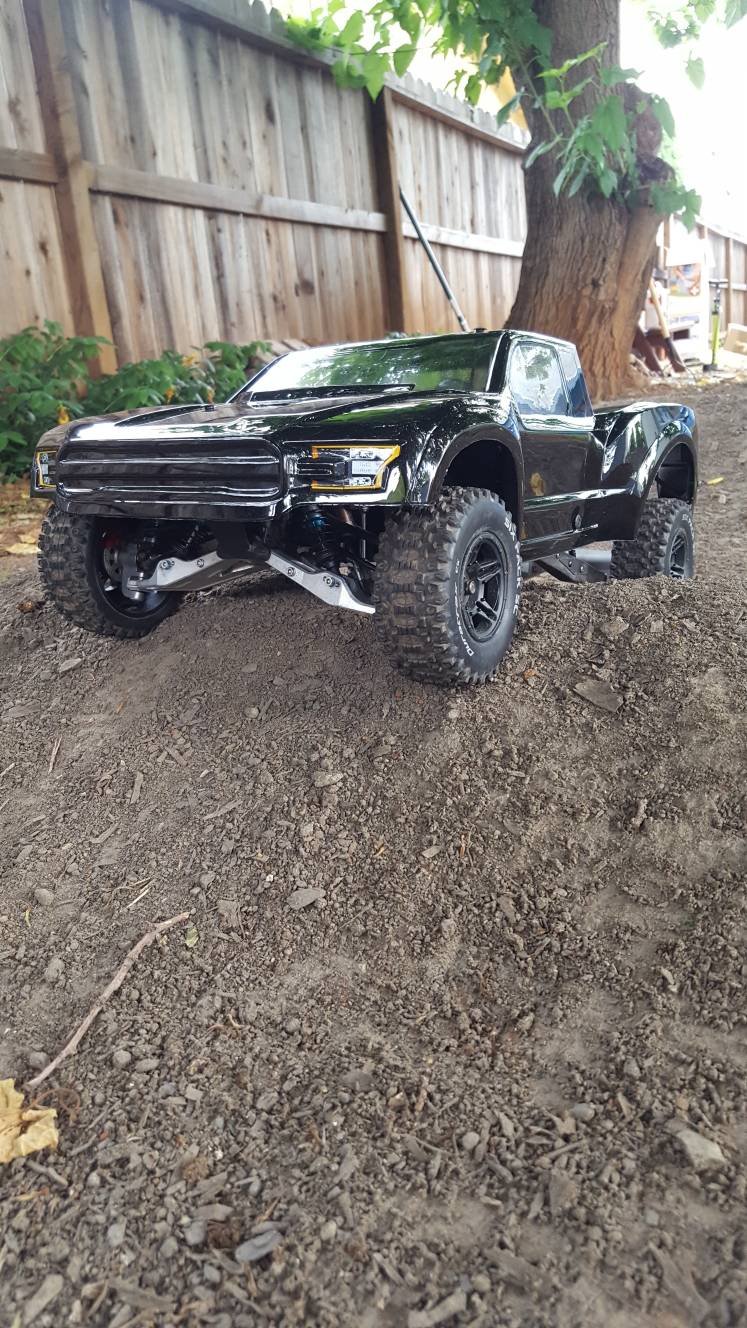

Thanks! I just finished getting my yeti raptor body on still trying to find some wheels and tires that will fit and still clear the fenders. Also still waiting for my front shocks to come in its been about a Month now.. haha havent Mounted the spares yet.
Sent from my SAMSUNG-SM-G890A using Tapatalk
Please

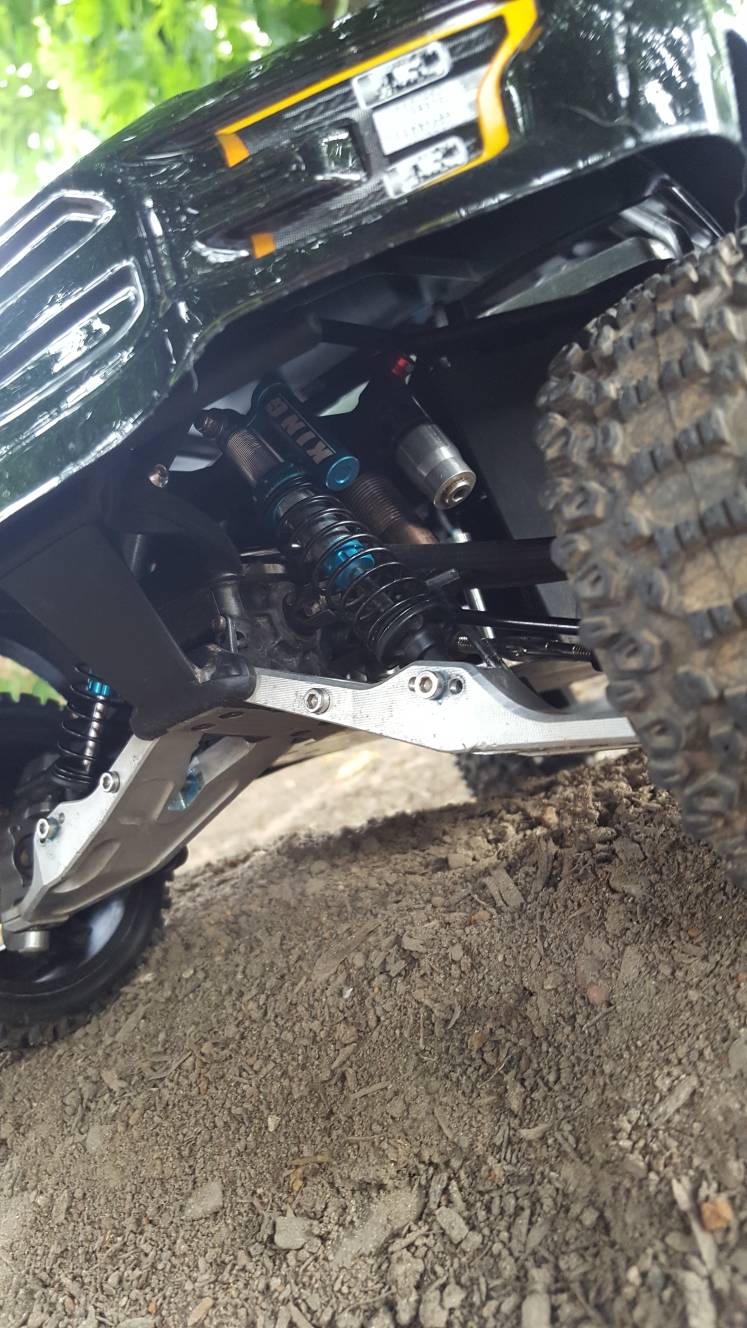

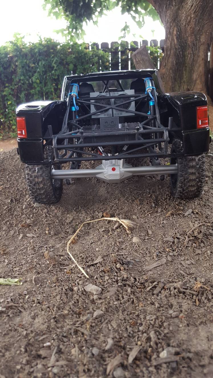

Send a photo of how you secured 2 shock absorbers on your car (On the front pillars of the suspension.)?

It's been slow going as I've been traveling a lot for work. I did get the Proline Power Strokes set up though. Bench test has them feeling good, but the first rip will be the true tell.

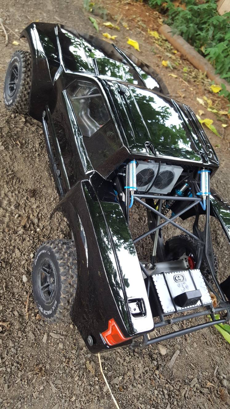

Still have some filing and grinding to do on the welds to get them all clean and smooth. Once that's done, the cage will get finished in STEELIT Coating.

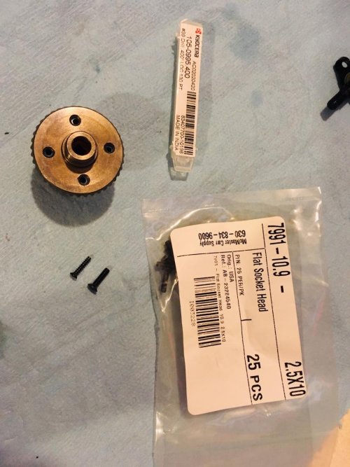

I did the screw mod to all the diffs on my new Baja.
Although, I did go through about 4 carbide circuit board drills to get through the hardened ring gears. We stock a lot of these drills at my work. I "borrowed" them. :ror:
You can see the significant difference in diameter of the stock screw on the left vs the new 2.5mm. Especially the minor diameter :shock:
I also had to drill out the holes in the plastic cup itself a little larger because of the diameter difference, otherwise it would crack the plastic. Think I used a #44 drill.

Yeah, the Exotek diff cups use M2.5 hardware and the holes in the ring gear aren't large enough for the hardware. I used a Dremel with a diamond bit to enlarge the holes. It took some trial and error, but eventually worked.
