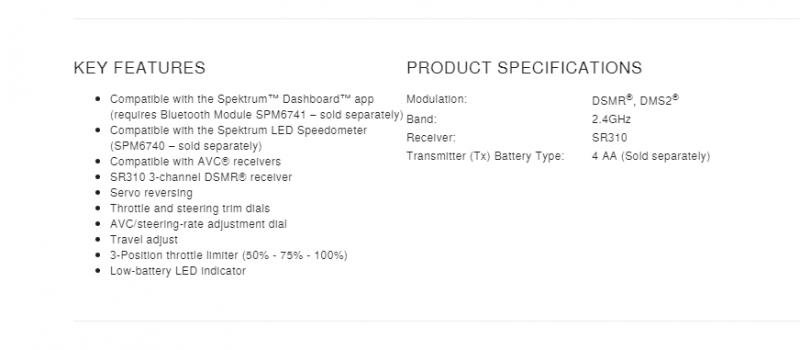

I ended up ordering a new "take off" DX2E (SPM2335) transmitter only off ebay for $25 shipped yesterday. Still being cheaper than the truck RTR version in the long run and has more features than old discontinued RTR DX2E (SPM2330)
Read this info direct from Spekrums site under "Key features":
"-AVC/steering-rate adjustment dial"

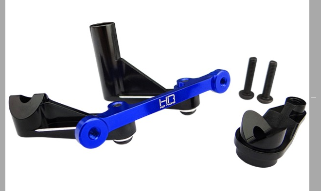

I would add an aluminum steering rack while you’re at it, Losi and hot racing make them. I have the cheaper hr one and after a year and a half Iv had no issues with it. If you are going to run 3s I’d get the vanquish rear end. Has much bigger pinion bearing and perfect gear mesh. It’s a much better set up and surprisingly light and helps with the nose diving off jumps.
I thought I read reviews somewhere (Amain) that the alum wedge style servo saver didn't work out too well? I'll look into that further.

It’s not the servo saver it’s the steering linkage and rack, you use the stock servo saver. If you can, get the prolines and I run the front preload down to almost half and very little in the rear and 35w front and rear. It jumps nice and level and handles great for a solid axle truck. I was running 60wt in the rear for awhile to slow rebound but didn’t like the way it handled so played with different weights and preload and finally found a set up that works good for me.

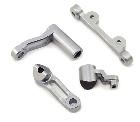

Sure looks like the servo saver is integrated to me..

The servo saver is a spring that’s adjustable that goes in it, I’m not sure what you heard but Iv never had an issue and it takes up some of the slop in the steering
Yes, I’m aware of the spring. I just read that the metal on metal wedge setup didn’t work well.
Either way, I decided to order the HR steering kit, new servo and SSD front bulkhead today anyways :mrgreen:

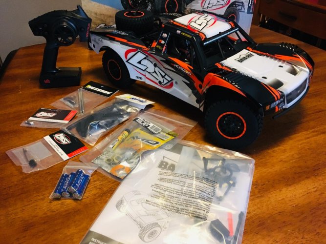

Well this will be a good start 😁
More stuff arriving tomorrow!
Anyone else get a factory installed light bar, FPV camera cage, and extra pinion with theirs?

Yep, my neighbor just bought the BND version while Tower had their special ($350 including a 5000mah 3s) and I thought it was cool that they're including the light bar now. They've always come with a 10t and a 13t pinion.
