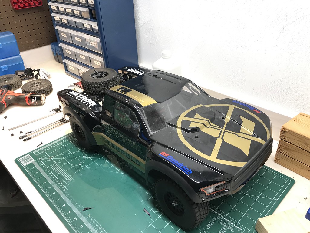

JDM74 - I picked up a Proline Raptor body as well. I mocked up with Vanquish Yeti trailing arms. I just wasn't digging the wheel arch to wheel alignment, even with the Yeti arms. Seems like I would have had to take a little bit from both front and rear arches to get in sitting centered, and then MY OCD would be triggered by the cattywompous wheel arches. :shock: My other concern was how the shorter TA's would effect handling and air-born prowess. The Baja Rey is a true aerial artist when you send it, whereas the Yeti, not so much. I think a lot of that and its overall stability stem from the longer wheelbase.
That said, I think i'm still going to use it, but my plan will be to cut the rear fenders off and just roll with the cab/hood - like they lost the rear fenders somewhere along the way! Probably do Redbull livery for that.

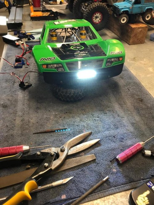

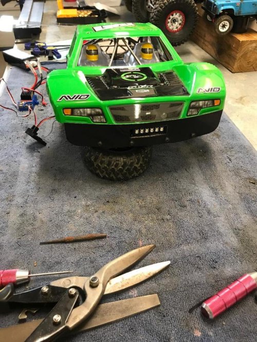

So, I got quite a bit more done last night. New front valence with a milled out reveal for the lower lightbar. Still working on ideas for a bracket for the lower (grill area) pod lights. Not a lot of real estate to work with between the body and cage there tho, so I've been scratching my head.

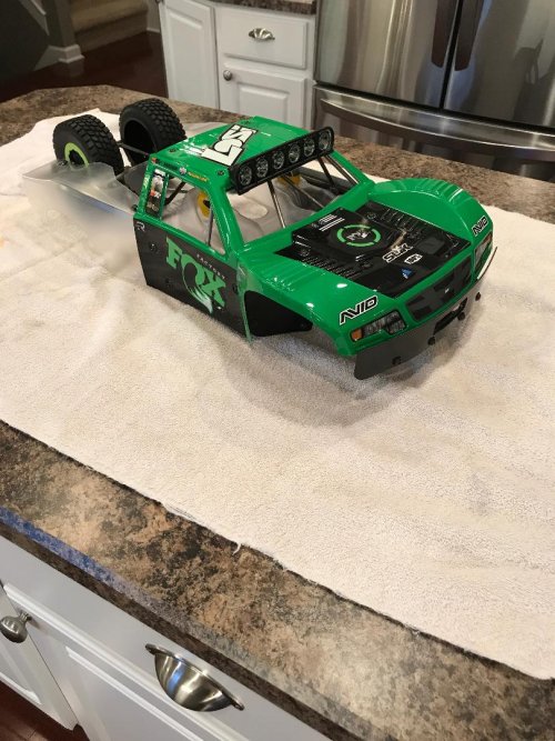

I've been working with and mocking up using my existing Baja Rey bodies, including this green, FOX livery. Hood and cab on the new body will be largely untouched in terms of fitment. But, I had to do some trimming and fitment for the rear fenders to accommodate the dual spares. Grabbed the new fenders and proceeded to measure, mark, measure again and slowly trim bits away. The kicker was that I had to leave the top, rear fender mount, but the spares were encroaching on the upper fender area. I just created a reveal for them along that upper fender line and made a nice, "organic" trim line around the upper mounting tab. It was a blessing being able to see through the unpainted fenders for marking up, trimming and test fitting.
Lastly, I marked up and drilled out the holes for the Proline Baja lights on the aluminum roof valence I fabbed up the other week. They're sitting pretty and solid up there now. I did also do a bit more trim work on the interior and it's fitting really nice now.
Anyway, I've got a long way to go, but making some steady progress. I can't even count how many times I've had the cage on and off the chassis now, inner body panels on and off the cage, and body on and off the cage. Yikes.:shock:
I'm still scratching my head on how to best create a "bed area" that looks legit. As I mentioned, I scrapped the 1 piece aluminum one I made and I'm back to square one. I just didn't care for how 1 dimensional it was looking. Anyone have any suggestions?????:cry:

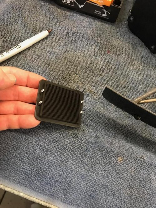

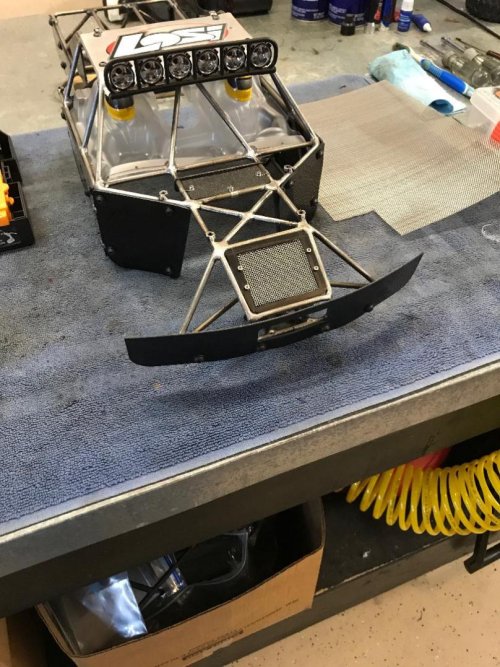

It's been slow going now that the Holidays are over and I'm back to the grind. But, I finished up the front mount radiator and shroud / trans cooler. There is indeed a 3D printed radiator behind that stainless mesh!:lmao:
