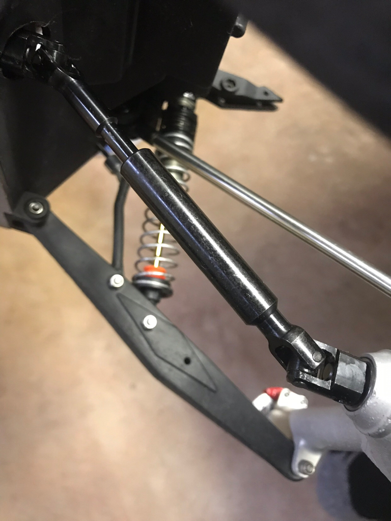

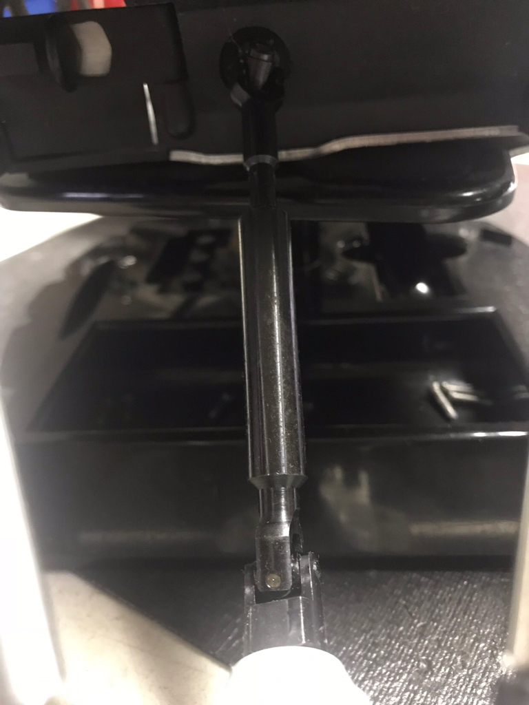

Got my SSD driveline installed today, so much better then the hot racing one. The HR one was to long, when the rear end was full extended the trans would get bound up. I had to use 2 proline bumpstops in each rear shock as limiters to where it wouldn’t bind. The ssd is perfect and to my surprise is pretty light.

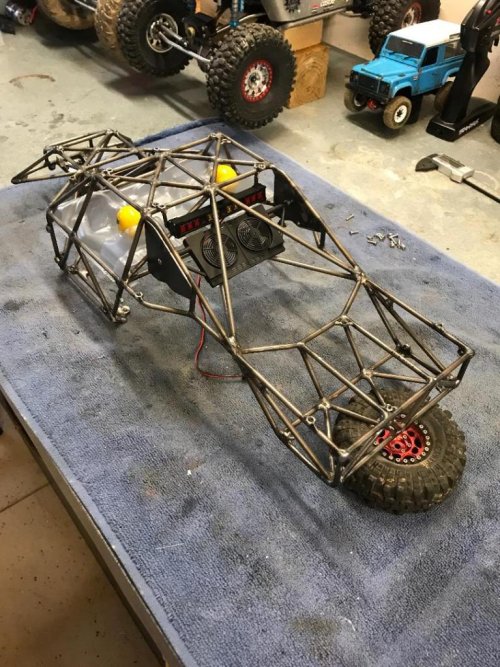

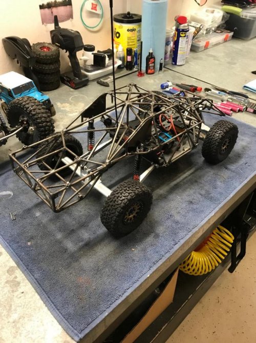

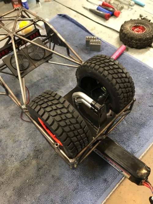

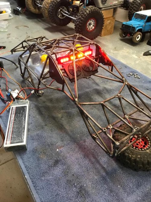

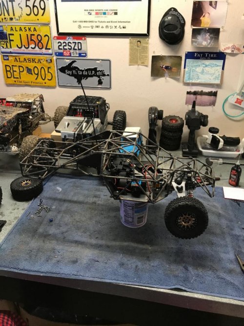

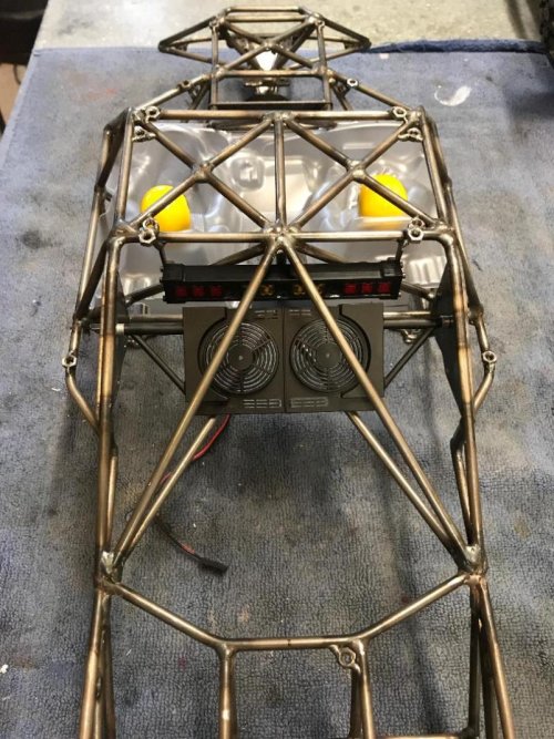

Finally got started on my Baja Rey rebuild with the full metal cage. Not unlike building 1:1, lots of mock-up, assembly, disassembly, repeat. :shock:
She is starting to take shape though and will definitely be getting some more scale touches than before. "thumbsup"
