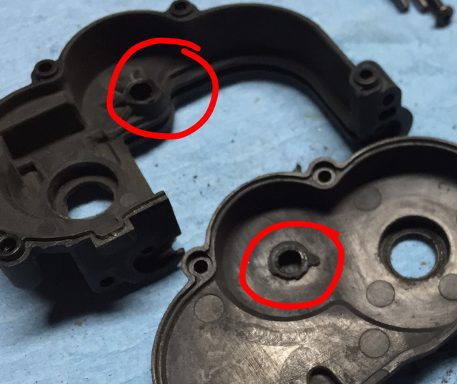

Seized bearings and melted case....
I'm starting to think a full bearing upgrade is in order here! Maybe Losi cheaped out in the bearings with this rig..😒
I just ordered a fast Eddy bearings kit and ceramic bearings for the axles for my rig. Haven't had issues yet, but considering it to be preventative maintenance.
I'm starting to think a full bearing upgrade is in order here! Maybe Losi cheaped out in the bearings with this rig..[emoji19]
Bearings are cheap, really cheap. Btw note how dirty the internals are. It's the cleanest I have pulled it apart from the times I have pulled it apart to do work to it. Silicone worked for me. I have tried multiple methods, this one worked the best for me.
Which part is melted? I'm not seeing it.

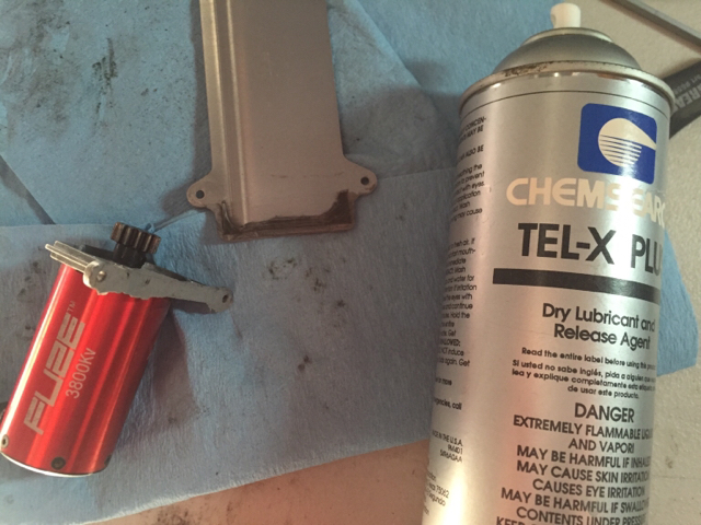

Those gears are meant to run dry. I use dry lube on mine that helps a bit and doesn't attract dirt, have also tried different forms of lubricant but I don't advise anything other than a dry lubricant.

Don't know how I got lucky on the silicone staying out and creating a nice seal every time I take it apart and put back on but here's a reference picture if you can see it and the dry lube I use for anyone following.
