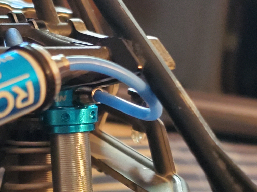

Ok...got the piggyback shocks installed. Despite being "cheap Asian imports" off eBay, they look really nice, and installed easily enough. Also, note that the piggybacks are NOT just for looks...they ARE functioning, with adjustable back-pressure. Anyway, I did, thankfully, discover something (and, it's A REALLY good thing I did) before installing - where the pressure hose attaches to the shock & piggyback, you need to remove the attachment point from the shock/piggyback, and use some Loctite. I'm not referring to the coupler that holds the hose into the attachment piece...I'm talking about where the attachment piece screws into the shock cap & piggyback.

Panther, are those 125mm RC Run shocks?
I bought them on eBay. The brand want listed, but that's what the sticker on the piggyback says. On eBay, they're just listed as '4pcs 123mm Negative Pressure Hydrolics Shock Absorber for 1:10 RC Car Model'. They were $65.99 for 4 shocks.
