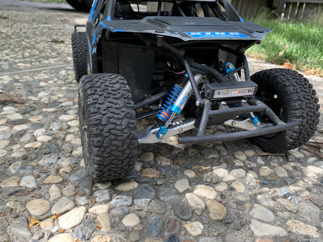

That’s why I decided to design my front like this…
Nnnooooo! Don’t do it panther! (Unless you’re going for the same, or almost the same, tread pattern). :)
I'm working on various ways of preventing the tires from ballooning. As for tread pattern, the K02 & KR2 have entirely different patterns. If you're referring to the KR2 and stick BR tire, one (NOT the stock tire) is of better quality, and longer-lasting.
Correct, KR2 and stockers to me, are virtually the same tread (And yes, the pro lines will definitely last longer! LOL.). I definitely like the chain interlock design of the K02s better. And it seems like they hook up better and Corner better. But that could be just my opinion based on my driving style.
