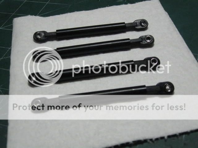

Got both of my link bushings today. These things are sweet"thumbsup" Such a simple concept.... wonder why nobody has thought of them until now:lol:
Now I just need to find my Delrin stash and make me some new links8)
Hey Doug I used mine today what a sweet little tool worked like a charm. I'll be posting some pics in my ~~Internationl Scout 1.9 Build~~ thread soon. Thanks Norm "thumbsup"
