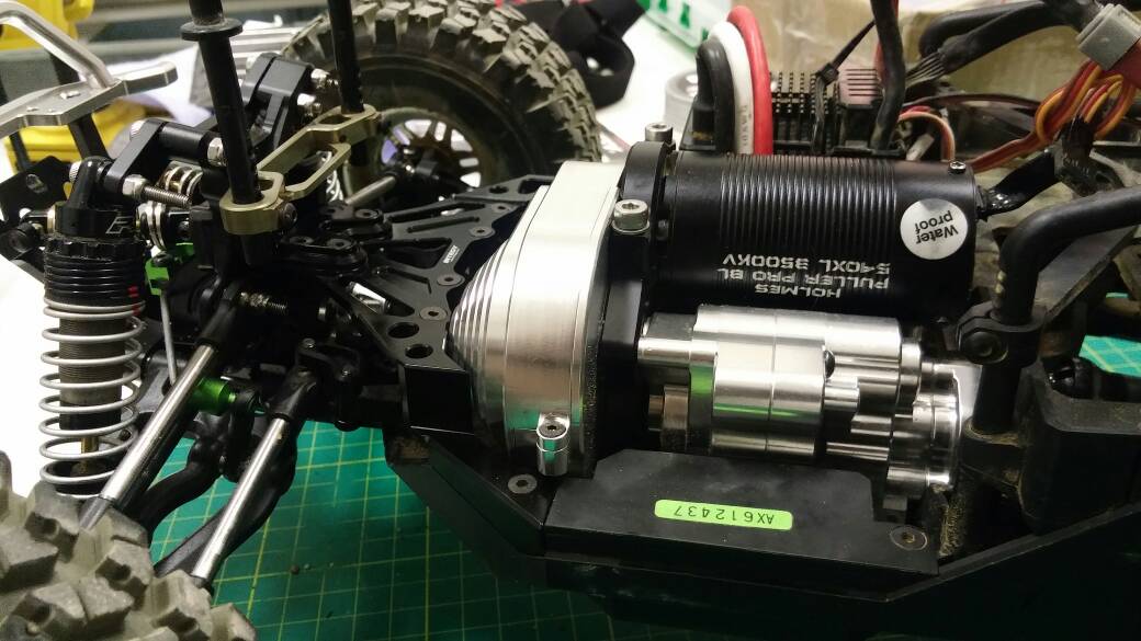

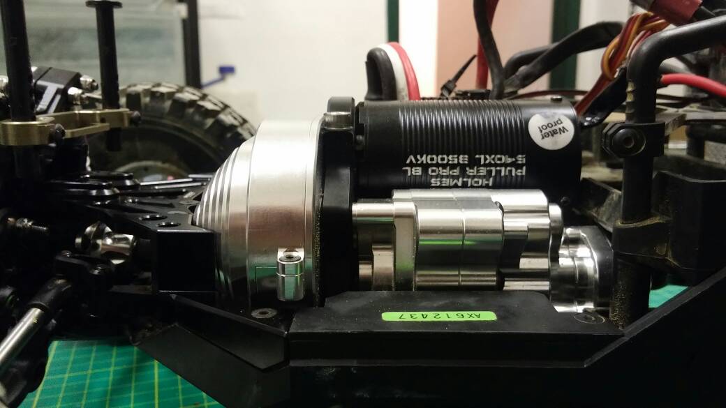

Today I finished front end and breaked into the rear once again to swap bevel gear back to stock. I wanted overdriven gears on both front and rear but Boom racing bevel did not fit well to the front. Axial HD on rear was OK but I do not wanted to have overdtiven rear and standard front - that is why I swapped rear back to stock.
Here is my rig ready for tommorow's run:

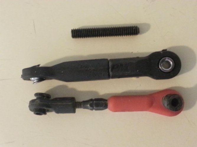

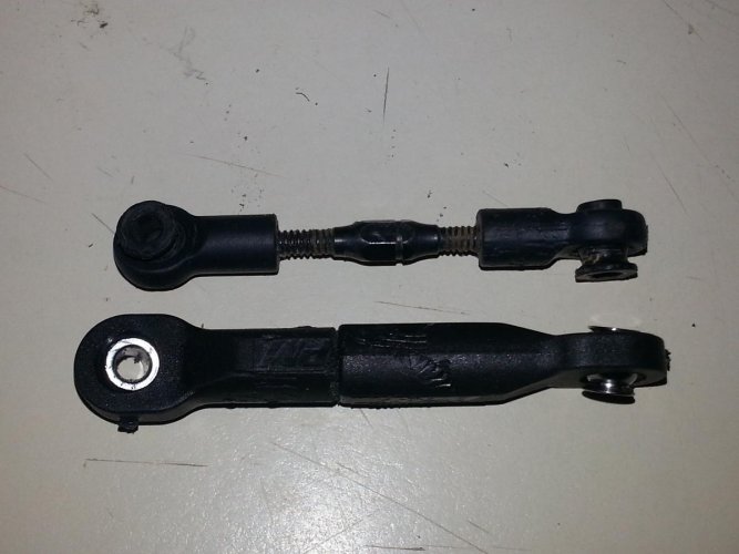

Made up " bomb proof " steering link for ya, rpm long arms, traxxas 3mm steel balls, 4mmx 25mm steel threaded rod, warning... wouldn't use unless your servo and servo arm are strong enuf for this set up or still have a servo saver in place. No weak links left to break inline now .
Before and after of stock, plus replacement end and after Monster RPM link.

Next to Axial supplied hardware seems a bit overkill but in a U4 Race you find out how tough your rig is, this was first piece to break on mine. Hasn't again since the upgrade.
