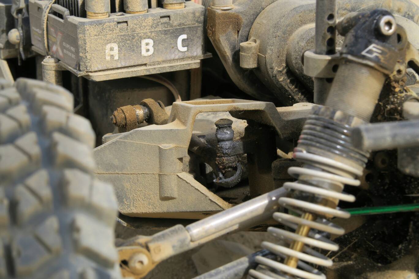

First signs of use on the Currie axle [emoji2]
It is amazing how rocks and small particles are accelerated by front wheels brushing surface of the rear axle. This is POWER. On 2S LiPo!
Yeah Racing bearings. Not good. Did not stayed the abuse. Tried to rotate them and all I heard was cracking of the sand. I will buy Fast Eddy bearings...
