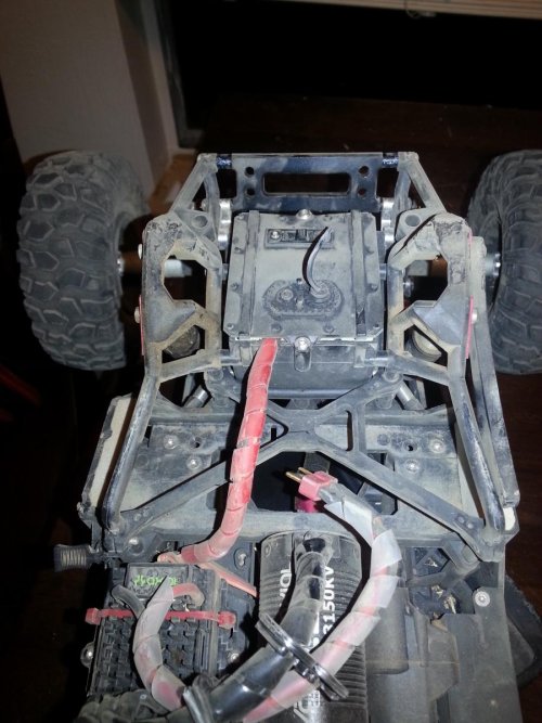

Looks good man, only suggestion is to get that reciever out of its hole and get it into the " fuel cell" , id drop a pic but cant seem to get this to take it.
Pardon guys, 47 yrs old here, how do you get allowed to post pics on this forum ?
Move that receiver out of its hole and into the " fuel cell" , any water above the pan and your day is over... ask me how i know LoL.
added a switch from an rc airplane and got the out of the silly stock location , looks factory to me.
Pardon so dirty, she had a long day today.
I sealed it already very well in original receiver box and I will keep it there as I do not want to diasassemble it again. Should be OK, and it is lower than fuel cell box - this should be better to put weight lower.
