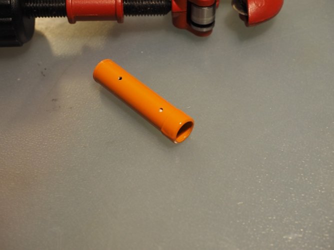

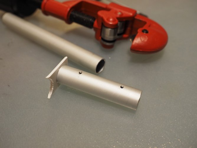

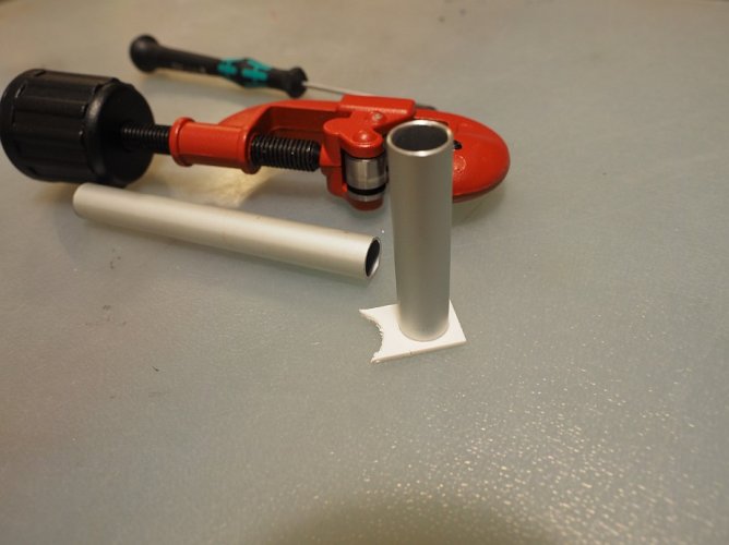

I started with a pice of aluminium pipe and cutted it down to the right lenght:
Glued a pice of styrene to one end:
Drilled some threaded holes for later attachment:
A small ring of heat shrink tube will make a nice pipe collar:
And paint, lots of paint:

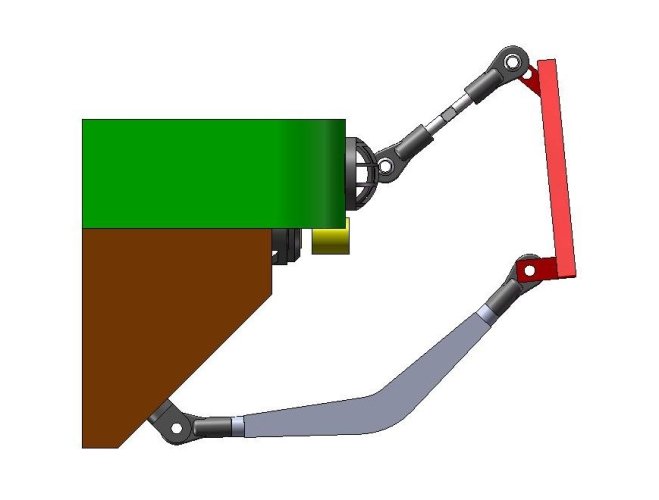

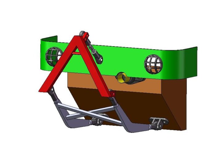

I am working on the "Schlepperdreieck", which is a coupling for farming equipment. Normally the coupling would be lifted hydraulically, which is hard to do in rc modelling. Even the geometry is giving me some headaches. So I did a rough sketch in CAD to see the interfering edges and get a feeling for the movement.
This is what I have come up with so far:

Don't know what the implement looks like but I think the lower push frame arms should be straight and fixed together so they won't twist.

You are right. A straight pusharm would be more stable. The pusharm is bend to give room for the hydraulic cylinder. I have added the cylinder in my drawing:
I am in two minds about the coupling. I really like the look of the big red triangle in front of the Mog. But it totally eliminates the aproach angle :cry:

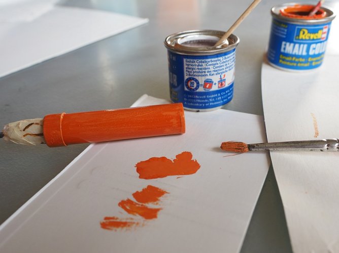

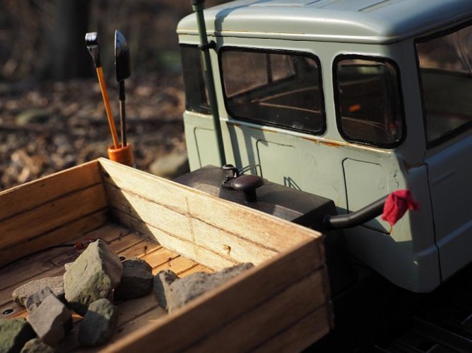

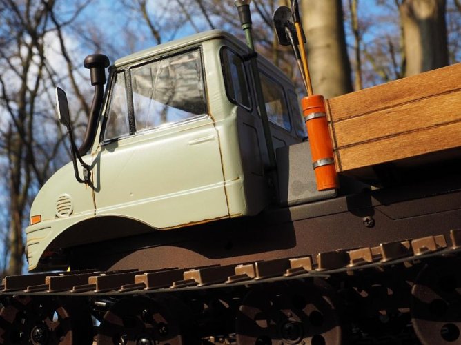

I finished the tool pipe today. I mixed some light orange to do a slight weathering job on the "plastic" tube.
Added some brackets by using small stripes of heat shrink tube and silver paint. Rust stains are made with a brown marker.

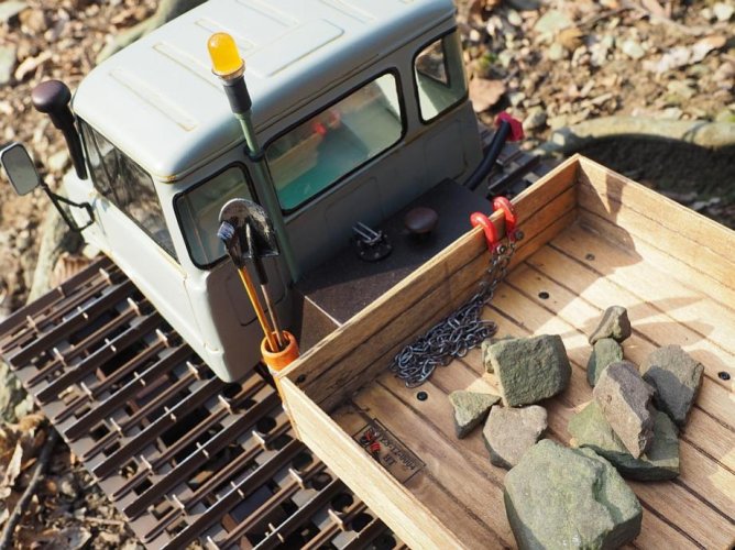

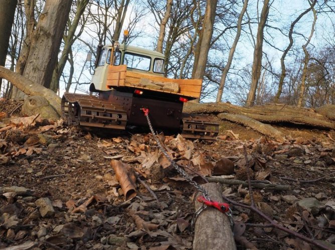

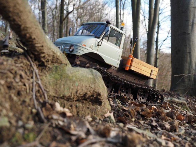

Weather was nice today so I went out for some driving and to take some pictures. Unfortunatelly the ESCs didn`t arm, so driving was canceled cause I had no tools nor the programming card with me :x
Good thing was, I could focus on the pictures. I hope you like them :)

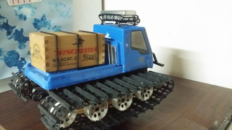

OK so here is my blizzard. I cut and attached rbrasion resistant rubber straps to the tracks it adds 3mms to the height. I live in Texas and we don't get a lot of snow so I use the plastic tracks with the rubber strips to go on trail runs and light crawling. During the winter I run the metal tracks.
Great job on the tracks, very professional! "thumbsup"
Cool cargo as well, don`t you have to put a warning sign for explosives on it to comply transortation regulations? :lmao:
Very true. These things last very well I've probably got 10 miles on them driving on dirt rocks and concrete. Make sure to upgrade to bearings from start to finish in your blizzard. And the chains will stay tight if you change the front to metal or run the solid bar on the front between the front sprocket wheels. If your running the Sr I think it comes with that bar it doesn't on the ev. Also or rc snowcats in the for sale section Gumbavi sells a full Metal drive trains for the Sr blizzard and in his he runs 2 out runner brushless motors off of the sabotooth it's the best ecs's for the Sr blizzard. Also the metal tracks don't hold up well to high speeds.
