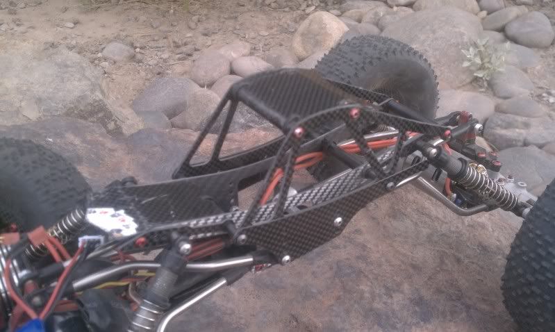

^^^ Looks good man"thumbsup" I like the all carbon look.

got my roof done "thumbsup"
Bad ass right there:shock:

Cool, the silver cf of the main chassis reminds me of snake skin. :twisted:

thanks.
Looks like a robotic crawler there. . . ;-)
i like robots!"thumbsup"
it does in fact
Very sharp. ;-)
thanks

How long is it? Still 1:10 or it's now 1:8?
1/10
