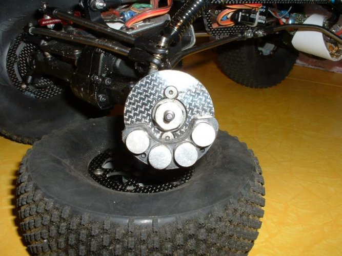

Drilled an eight hole pattern into a 42mm piece of delrin, drilled the center out, and cut it in half. Pressed some tungsten weights in and some knuckle weights are born. 4.2 ounces each.
It took most of my time today. Except for my 4 hour nap:lmao:to try to get back to sleeping at night. The weights are on. This gave me 2 more ounces up front. There are 16 total derby weights. This stuff just barely fit in there. I want to go out to the pile and try it out but cannot. Its storming again.:roll: Any way here are some pics. That is what we want to see anyway.
