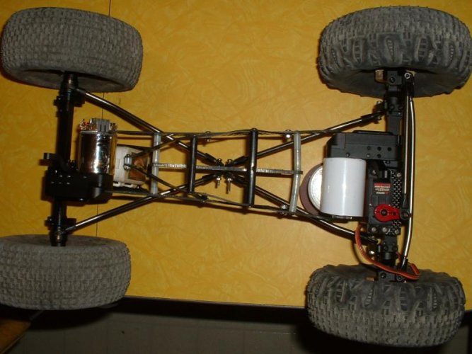

I have some Vanquish Ti links coming that I am going to bend myself. Would have already started, but the usps dropped the ball. I live in ohio. They come from California. What are they doing in New Hampshire? Clear to the east coast OOPS! Oh well I have more toys to play with until then.
Got my links and bent them up. Just barely enough room to full steer. Just lightly rubs. Used the absolute longest lower lings I could without putting them on the same bolt. The weather is starting to clear up. I am getting excited for a little test and tune. I am going to use some scx shocks with jeepin doug spring cups. I got them filled up with 45wt oil and am waiting for the mail man. I am going to start with losi mini t rear silver springs. After getting the chassis on there I can't decide if I want to put the battery behind the motor or on the axle.

Made some upper links from .156" CF tube.
Put my scx shocks on with external limiters.
4.41 #'s already

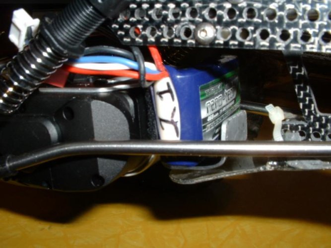

Straightened out the battery mount and distorted it to my liking. Couldn't bring myself to trust the CF links. I replaced them with some more 3\16 Vanquish. Added a skid plate too.

Would I be wrong in thinking that when the front end squats down that the leading edge of that skid plate would just about drag on the ground? I'm not trying to knock your choice of chassis...but I'm trying to understand why you'd need all of the extra holes...extra material, and that particular design for a skid?
I'm sure you've got benefits that you see...just curious what they are..."thumbsup"
It wouldn't be mine if it was from the usual cookie cutter.
The skid is lexan and conforms to what ever shape it needs to meet.

No worries...good catch on that typo...got it fixed now! I guess what I was saying about the skid was more that it looks like when you front dig and the rig squats that the leading edge of the skid will be hanging down...to catch on things. I understand it's lexan and that it will bend and such, but seems like you could come up with some sort of way to keep it tucked up...maybe a light duty spring or something to keep it tucked up out of the way.

IvVaum most people buy ones that are prebent. I used a vise and my hand putting one next to the other getting one very close to the other. It is difficult but doable.
Ryan when the front suspension cycles it only drops the skid down to the level of the bottom of the motor. I usually set my rigs to cycle up and down very little while getting about one wheel of articulation. The skid is bent up a little at the front creating its own spring action. Honestly I have no idea what exactly this rig is going to do until I run it. To me it looks like it work just like everything else I have set up. The only difference is that it will cycle up and down considerably more than my last rig.
