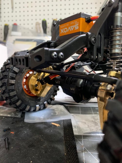

Nice build. I'm in the middle of building mine only with all yeah racing upgrades. ( Just want a heavy low CG good crawling truck). Concerned about the angle of the front axle. Is the axle on the TRX4 suppose to tilt downward( output shaft of diff point slightly down). It creates a steep drive shaft angle and looks odd. Control arm are kicked forward, just makes the whole axle look like its rotated about 20 degrees. Thanks for any help

That doesn't look right to me. The pinion shaft should be pretty much parallel to the ground. I'd double check against the manual for anything that might be off.
