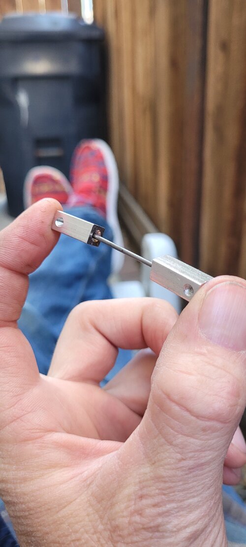

Here's my example: A piece of rod inserted into two servo posts17294533056184550845929539825073.jpgthese are regular alloy servo posts. Give a plastic set a try. Cheap and plenty to try. Put this between your ram and knuckle. Make sense?
I thought of aka "heim joints", and there are decent ones, but at 4 you're introducing 2 more pieces that can gain slop over time.
With the alloy servo post cut down a bit, and milled to width to fit your application, you can then take whatever M3 hardware and thread them onto the posts. Looks pretty and should be sturdy. Can be done with a file too!

Here's my example: A piece of rod inserted into two servo postsView attachment 508048these are regular alloy servo posts. Give a plastic set a try. Cheap and plenty to try. Put this between your ram and knuckle. Make sense?

They look really good. What brand did you end up going with? Any play?
No more play than stock. Not sure how long they are going to last but I got a boat load of them so I can swap them out if they get loose. As far as brand goes, I found them on Amazon and they are unbranded so I am sure they are the best Chinesium.
