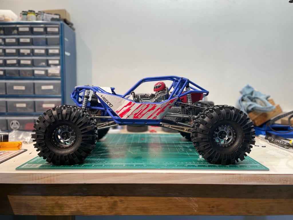

JDM74's Ryft Build
I'm not sure but it has been skidding on its lid since this pic was taken and can't see any color fade at all. This 3800 kV motor on 3S is a bit too much, lol. I'm going to try it on 2S and see if it comes close to sanity.
I couldn’t imagine 3s on 3800kv lol. My 4s 2400kv is theoretical 40000rpm. Your 3800kv 3s works out to 47000rpm. Blistering lol. I like it much better with 13t pinion low gear 4s. Is just about near perfect for any situation
How do you like the Proline dual stage foams? Do they fit and fill the tire well? I was debating them but typically use CI foams. These are the tallest tire I've had so far.
Truck looks fantastic "thumbsup"
I think they do a pretty good job of filling the tire but not over stuffing it.
3800kv on 3S is WAY, WAY too much. I'm only running a 3200kv (also on 3S) in my R4sty. Did the Ryft, as many others have mentioned, probably shouldn't go any higher than 2700kv for 3S (on the stock gearing). It's no wonder yours has spent so much time upside-down.

Well I am running a 13 tooth pinion.
I'll take the 2700kv & stock pinion, as opposed to "being a turtle". [emoji1687]

Haven't 'tried' anything in the Ryft...at least, not yet. It's ready for "final assembly", but was still waiting for my 'special' items coming from overseas. I've got everything installed on the skid, the cage is together, the tires are mounted, the axles are fully assembled, the Traxxas GTR shocks are ready to install...just need to put these 'groupings' together into a vehicle.
I know I'd have to partially disassemble things once my 'special' items arrive...but, if I temporarily get the vehicle operational, at least I'll be able to get initial testing done...so, I think that's what I'll do.
At the same time, I have tested the Pit Bull Growlers, Hyrax 1.9s, and Hyrax 2.2s on my Capra (ran the Hyrax 1.9s on the Capra at Scale Nationals), and all are excellent. Something I'm considering (especially if the stock Swampers don't work) is the Hyrax 2.2s in G8.

And...ended up mulching the front diff (the only one that isn't locked) so spool in in route on the slow boat.
All in all, pretty happy with it. Need to find some more hills!
Rebuilt my F diff. So far slow K but not really had a chance to run it. Have a 3rd axial locker here for when they go tits up.

Mounted up with new front spool installed
I had to go back to the stock foams. The Proline dual stage were just too big for the inside of the the USD Stickies. I way even drop back to a 5.5 double deuce CI foam in soft outer front and soft outer rear. Anybody have any thoughts on the USD's as far as foams go?
Been a year since I last updated this thread almost. I have a 2700 kV motor on order from Holmes. Hopefully this will tame this beast a bit. Once I get it in I will take it out and test these tires and the new reduced speed out.
