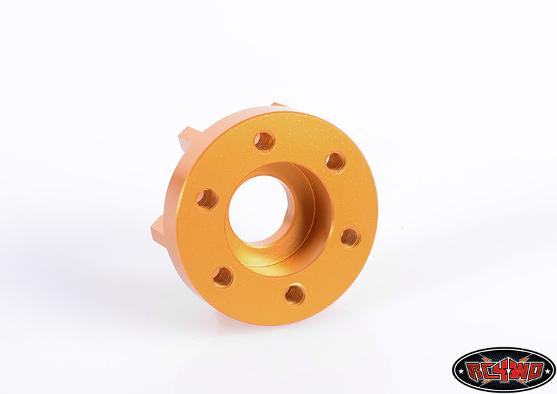

It depends on the bolt circle for those RC4WD adapters. Jconcepts has a different bolt circle than other hubs so it is very possible the RC4WD adapters won't work.
I have an idea, i think we can find out if these adapters will fit.
But we have to know 2 dimensions first from someone who has these wheels.:mrgreen:
What's the length of hole to hole (green line) ? and what's the length of hole to across hole (red line) ?

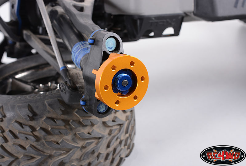

Did anyone ever find a solution to this? I've been searching for the same solution. RC4WD has wheels that can be used with those 17mm adapters, but hey are so massively heavy. I'd prefer the lighter JConcept Tribute wheels if possible.
Weights per wheel not including tire:
RC4WD Universal Monster truck beadlock wheels weight: 11.9 oz
JConcept Tribute wheel weight: 3.45 oz
I'd really like to put some monster truck tires on a Tekno with 4s. So 12mm hexes are pretty much out of the question for me. 4s is to much power for 12mm hexes.

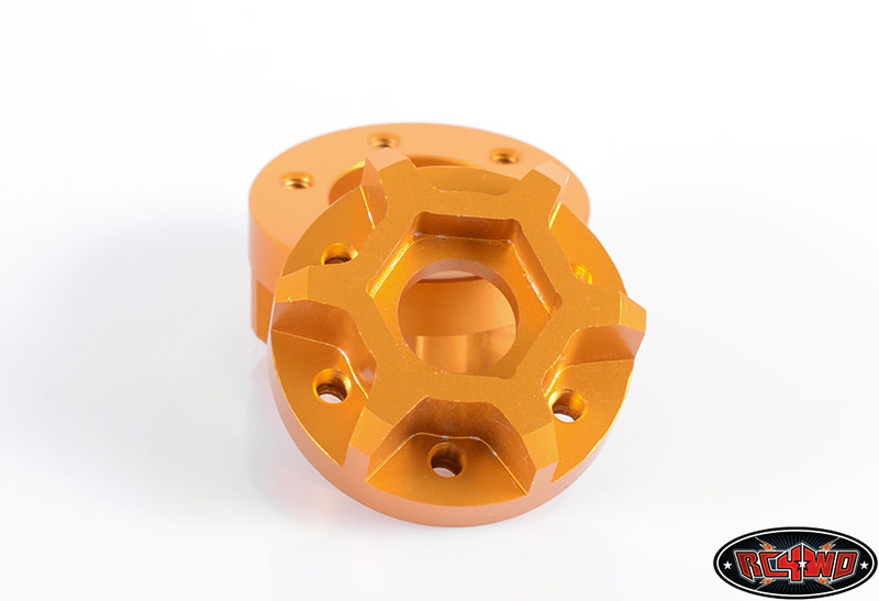

I got some good photos of both the Tribute hub and the RC4WD hub and did some photoshop magic and got a measurement estimate. I assumed the Tribute wheel hub was 12mm and used that as my measuring point. I assumed the RC4WD hex hub was 17mm and used that as my measuring point. With those measuring point I measured the distance from screw hole to screw hole. Here are the results.
Tribute hex adapter:
  • hex length 150 pixels (which is 12mm)
  • top of screw hold to top of screw hole is 254 pixels
  • So 12.5 pixels per mm. So the screw holes have a center point distance of 20.32mm
RC4WD hex adapter:
  • hex length 160 pixels (which is 17mm)
  • top of screw hold to top of screw hole is 243 pixels
  • So 9.411765 pixels per mm. So the screw holes have a center point distance of 25.819mm
So the screw holes do not line up. Which means the RC4WD adapter will not fit on the JConcept tribute wheels.

Hell yeah, that's the Truggy right? That's similar to a build I'm planning out. But I need a solution to this 17mm hex issue. RC4WD has some wheels that can work, but they are very heavy and I'm concerned they'll cause to much stress on the drivetrain and motor. So I'm still trying to find another option. JConcept Tribute wheels are a fraction of the weight as the RC4WD wheels.
I hope we can get a definitive answer on the fitment. I would like to put some monster truck wheels and tires on my Arrma Talion for the winter.
My measurement estimates say hell no it won't fit. I wouldn't be surprised if my estimate was off my 1mm or so. But it says it's 5mm off, so that's not even close. I thought about drilling new holes into the Tribute wheels, but I got some good pictures of the wheel and i don't think that's going to be easy. They have some weird plastic parts in there right where i'd need to drill. I think we need a different wheel option all together. These JConcepts wont' work unless JConcepts makes an adapter for us, which they aren't. I called and asked lol.
I'd really like a wheel that's not so heavy and full of metal like RC4WD beadlock wheels. Proline has some 3.8" wheels with 17mm hex adapters, but their clodbuster style wheel doesn't support their hex adapters which is pretty stupid.
