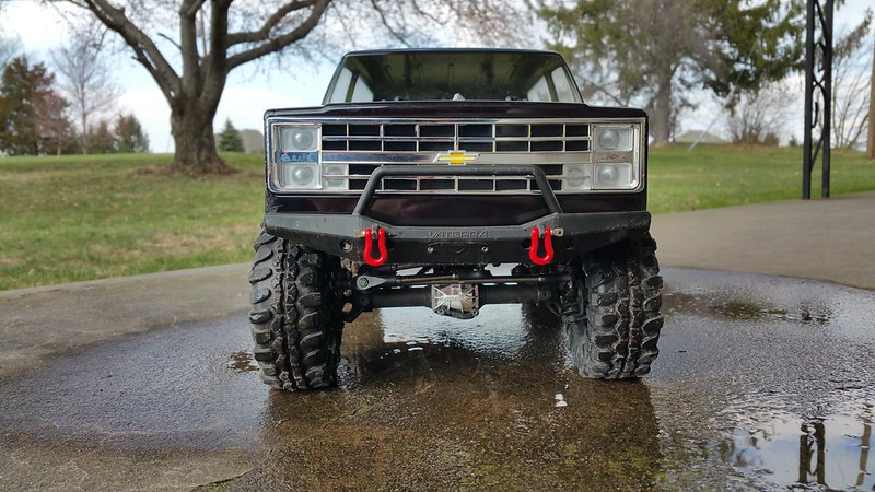

I also added some Yeah Racing red D-rings just to add some accents.
